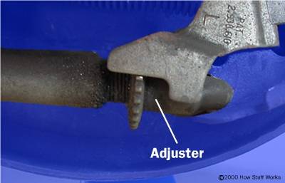

The problem isn't with the parking brake, its the adjuster for the brake itself. Check the attached photo. If your drum won't fit, either you have forgotten to adjust this screw or if you have adjusted the screw and it won't turn anymore there is too much corrosion on it and you need to replace it. Whatever you undid on the other side of the car, it is best you redo it and set the adjuster on the brake itself correctly, otherwise it could go beyond its adjustability, at which time the mechanism in your brake would fall apart, and we all know how horrible that can be.

Yeah, I would the adjuster above right in and it still wouldnt go over. I wonder if the shoes were a few thou over spec.
solution was.... facemask, dremel with grinding stone, lots of dust and trial and error (with a bit of kicking the drum)
You will all be cringing now, (HE DID WHAT) but it worked, brakes are fine too but they did run a little warm to start ;-)
