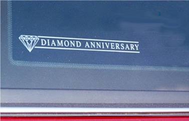

75 years of the Lincoln Motor Company of course!
all the Diamond Anniversary Mark VIIIs had this etched in the quarter window,

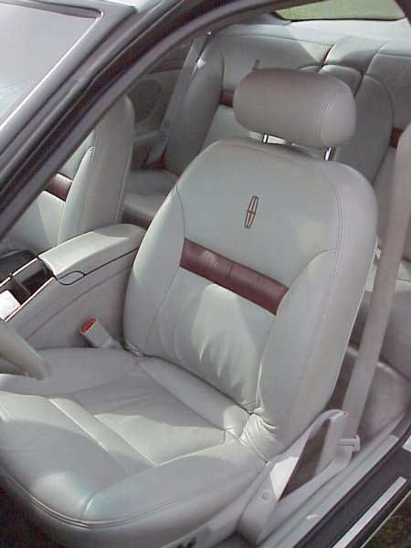

and this interior.
exterior color was either silver or cordovan.
the Collectors Edition din't come along until 1998.
Oh man, I want those seats so hard. Not that there's really anything wrong with mine, but those cordovan inserts are just too rad. Anyone worth their salt looking at the car would know it isn't a DA though, since I have no etching on the quarter windows either, and then I guess I would kind of just look like a douche. But man, those seats though.
Youre confusing the whole base mark viii, mark viii LSC and mark viii diamond anniversary still. Everything said above is correct but all "diamond anniversary" package mark viiis came as a base mark viii as in they all had the side moulding chrome and chrome strips on the bumpers along with plain haloven headlights..literally the only thing you got with the diamond anniversary was special 1/4 windows with the DA script in the glass and the two tone gray and cordovan interior as well as two outside color options: silver frost or cordovan. Many mistake any 1996 model year lincoln as a diamond anniversary because it was lincolns 75th year in production..but unless it had the actual DA package its not a DA. As far as the LSC goes they were a seperate trim package from the base which included monochromatic bumpers and trim (with no chrome strips embedded), HID headligts with unique clear lenses, true dual exhaust, 3:27 gear opposed to the base 3:08, and perforrated leather seats..and as stated the diamond anni ersary package was only offered on a base mark viii...there is no such thing as a diamond anniversary LSC....if all of that makes any sense to you.
