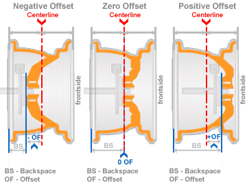

    On paper, your wheels (and their contact to the ground) will be shifted farther out from the car by 20mm per side (Wheel Offset Calculator). I don't have much experience with this, but intuition tells me that your suspension would get softer (longer lever on the same arm). From what I've read, steering feedback will feel looser when you reduce offset radius. I think generally changing wheel offset for aesthetics negatively affects performance, but I don't think it will make a noticeable difference in this case.
    As for fitting all that brake hardware in there, it depends on the actual geometry of the rim, how thick the spokes are, etc. On a rims where the spokes connect to/close to the front of the lip, generally a smaller positive offset creates more space in that pocket. But, again, depending on the exact geometry of the rim, that's not guaranteed. My gut tells me that you'll have more space. However, if you don't, you can always add spacers, to a certain limit.
    This should illustrate what I mean. See how with the larger +ve offset, the caliper is jammed up against the rim:

    Thanks for the diagram!!! :cool: It will help me know what to look for... and if I understand correctly going from a 60mm offset to a 40mm offset will give more room for the caliper/bracket relocation and larger rotor. And yes... the spokes connect at the outer lip of the rim

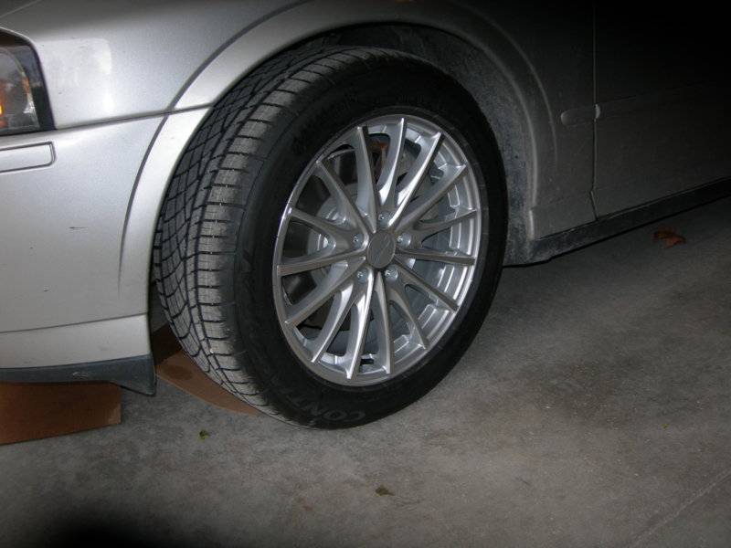

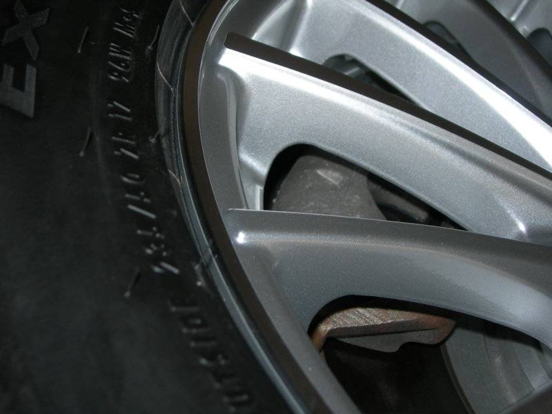

        Well... they're on. Plenty of clearance on the caliper. They definitely protrude more than stock,,, but still, (barely), tuck under the wheel well. Minor pics. I stopped taking complete pics of my vehicles years ago... because usually within a few months of taking pics,,, the vehicle would be boneyard material.
        Plus... the "car season" for deer is starting now,,, and I don't want to jinx myself. I'm normally not superstitious,,, but with me and pictured vehicles, there is an unplanned pattern that can't be ignored.
        So here's all ya get:
