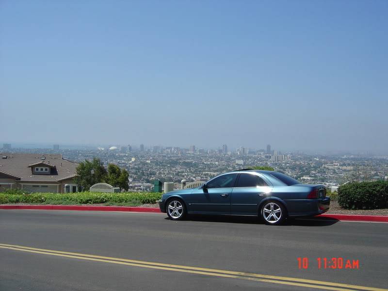

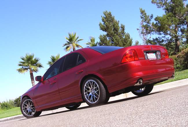

Looks nice, what color is your LS? I have 18s, here is a picture. Before I had 20s. They look great, but you get bad MPG, and the car gets slower.

I have 20's and i like the way it looks handles great and really havent noticed a big change from the stock 17's but 02sports car is one of the nicest ls'es ive seen and its on 19's i think it just comes down to your own prefence on size.
Hyelife that is a sharp car. I have a 2002 LSEV8. Its black. I will get some pictures posted up after the exhaust and wheels go on next week.

Besides, check out the shot of HyeLifeLS's car, why do they need to be any bigger than that? Those are happenin.....
