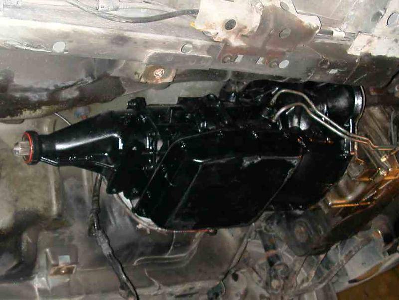

i put a 2002 mustang gt trans in my 95
Swapped mlps,one solenoid inside and repinned harness(simply moved pins from one hole in bulkhead connector to another).
i got the trans with 60k on it for $400, and decided to do this since i read on mustang sites the late gt trans were factory rated for upto 450 hp,i know i will never exceed that level.
I had absolutely no problems after converting(some peeps have had there share of probs,i guess i got lucky)
i absolutley love how the gt trans shifts with my stock computer ,the 1-2 shift is wonderfully firm and the 2-3,3-4 shifts are quite nice too,considering i did nothing like jmod or anything,just the fact that the gt trans valve body flows better made my car exactly how i wanted it trans-wise.plus as i said before,i did this on a stone driveway with jackstands and absolutley 100% by myself start to finish,an extra hand here or there would have helped but i didnt have that option,so if i can do it,anybody can,just take your time and think about what your doing.
other benefits were deeper trans pan and of course all the upgrade to the 4r70w since 1995 (1993).
oh,and the speedo was off because the later trans have 8 tooth shaft instead of 7, speedcal fixed that though.
good luck with whatever choice you decide
