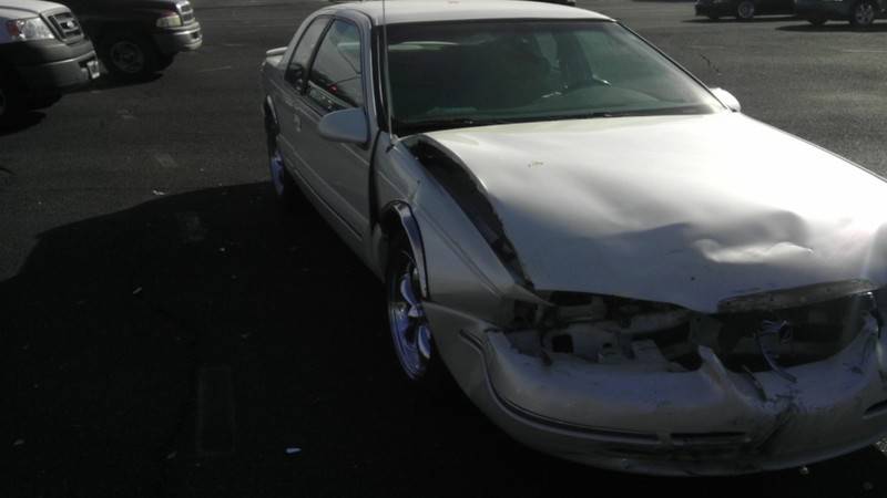

This is the wrecked 97 Cougar (it was sold back to me for 250 bucks, and they gave me 4300 bucks for it, really!):

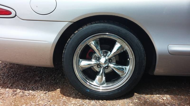

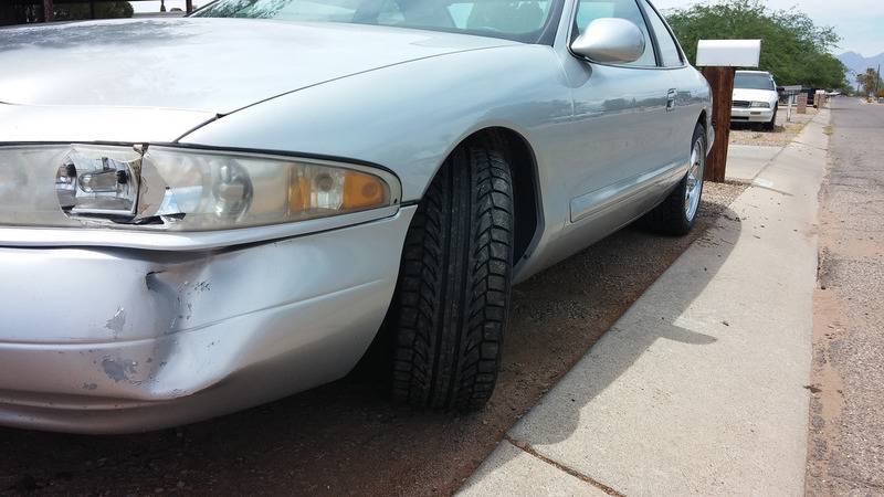

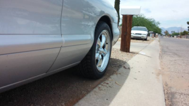

Current "wheel gap":

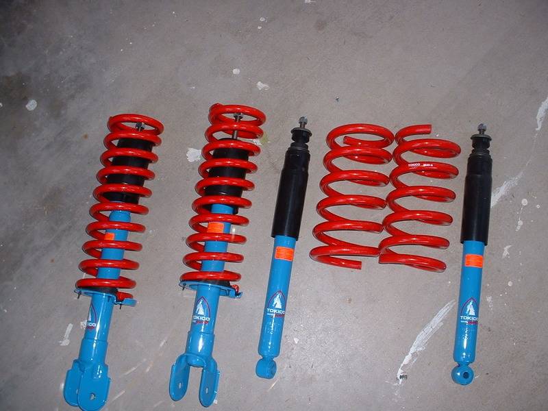

Tokico springs and front shocks (the rear shocks are trashed, the upper mount broke on both):
