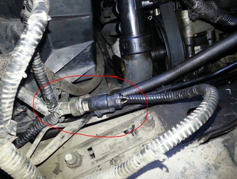

fabrizio Active LVC Member Joined Jul 23, 2014 Messages 182 Reaction score 11 Location Mex Apr 24, 2016 #1 Hi! Today I saw a power steering leak(maybe PS) so i removed the air intake and discovered a loose cable . 2001 LS v8 The electrical cable has 3 wires and fits to a aluminum tube What parts it is ? Is it a sensor ? I can't find that part in repairs manual. Best regards!
fabrizio Active LVC Member Joined Jul 23, 2014 Messages 182 Reaction score 11 Location Mex Apr 25, 2016 #2 Looks like it's "Ac pressure transducer sensor" Connector c1260. I'm not completly sure . Best regards!
O oddball Dedicated LVC Member Joined Aug 18, 2010 Messages 1,300 Reaction score 93 Location Dallas, TX Apr 25, 2016 #3 Yup, A/C pressure sensor. I don't know if that's the high or low side off the top of my head though.
joegr Dedicated LVC Member Joined Dec 10, 2005 Messages 21,568 Reaction score 2,364 Location Gulfport Apr 25, 2016 #4 oddball said: Yup, A/C pressure sensor. I don't know if that's the high or low side off the top of my head though. Click to expand... There is only a high-side sensor. Nothing on the low side (except a temperature sensor on the evaporator).
