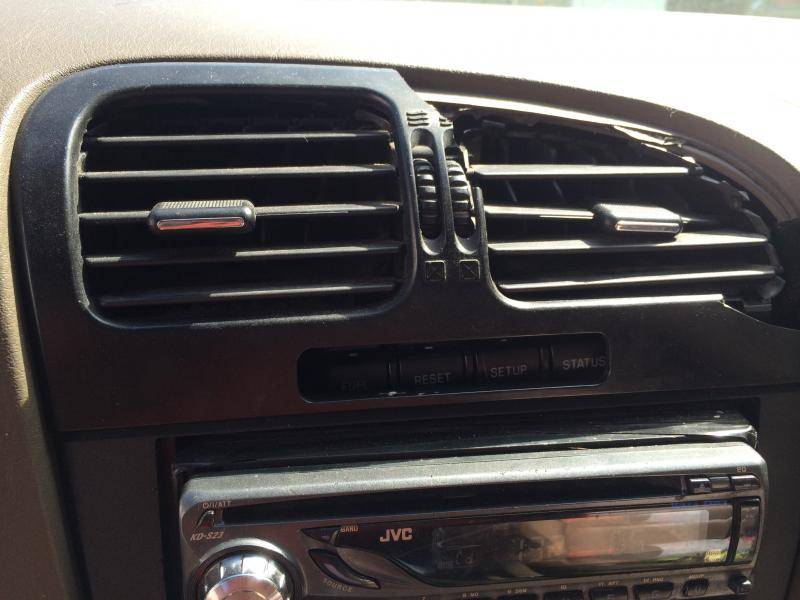

As far as color options what color would match, I am also looking for the plastic part that's located by the "fuel" "reset" etc controls. The plastic mount is broke . Also looking for a rear right shock as it squeeks over bumps image.jpg

Are you talking about the center vent panel being broken (not uncommon)? If so, you are in luck, it's may still be available.
19893B Louvre Assy - Vent Air
Replaced by: **4Z-19893-BAA **4Z-19893-DAD Black, Center - Double Register
LHD, With Message Center 03/1999 to 07/2000 1 $133.16
http://www.fordpartsgiant.com/partl...~2000-lincoln-ls-1952284-1953458-1592329.html

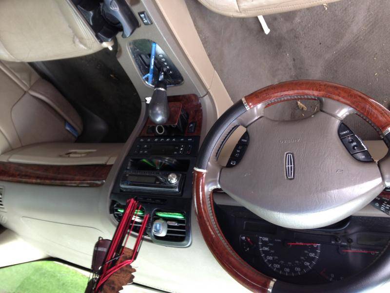

Sorry about the upside picture, but next to the kids graduation thing there is a air vent that plastic section is broke
