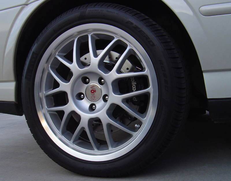

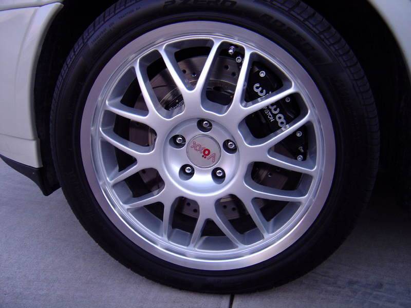

Not sure the luck you'll have with stock size rotors cross drilled and/or slotted. They notoriously have a decreased life expectancy in stock size. The Ford Focus SVT has the same size rotors the LS does.........
Anyway, if you want to ensure you're not losing capacity to absorb heat do a kit. I did 14's in the front with 6 piston calipers and 13's in the rear with a parking brake caliper to retain the functionality of the rear parking brake. This set up does not get hot and no amount of smack talking by the anti cross drilled crowd will make this a bad set up. I've had it over a year and no cracks, no heat issues and powerful repetitive braking from high speeds doesn't show any fade or decrease in brake effectiveness.
Give Todd a shout at TCEperformanceproducts.com as I'm pretty sure he has the adapters for the LS available for the Wilwood upgrade.

Big problem there... You're not using cross drilled factory replacement rotors. It's a huge quality difference when compared to the junk cross-drilled rotors most of these guys are throwing on their cars.
I'm not a huge fan of cross drilled just due to loss of surface area, but that doesn't mean they aren't effective for the purpose intended... stopping your vehicle.
