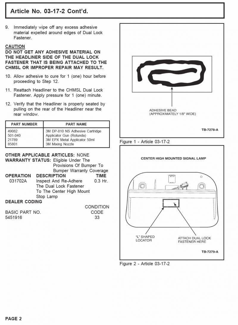

Yes it was a factory fault. Had the dealer fix my 2003 under warranty. This is the TSB TSB03-17-2

I really doubt that his is dropped in the center. The common problem with the LS gen II headliner is that it drops at the rear window. It only needs to be reattached to the third brake light at the back, where it has come loose.
It won't let me attach the pdf, but here are the pages.
