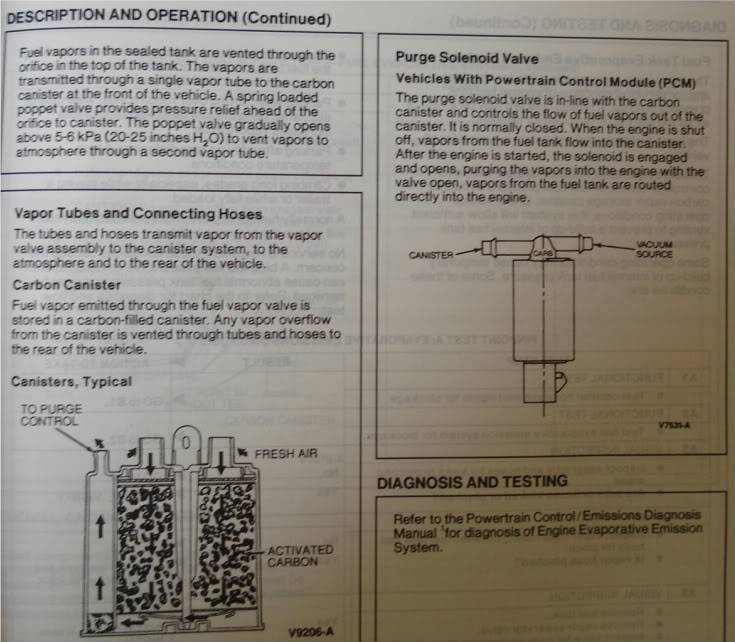

And what does the purge system do? I noticed when comparing notes with Tommy that his canister purge parameters are very different from stock. So I guess this is a two part question. What is it and what does the system do exactly?
FORD PART NUMBER: E4ZF-9C915-AA
It's described in my service manual... I'll take a pic.
