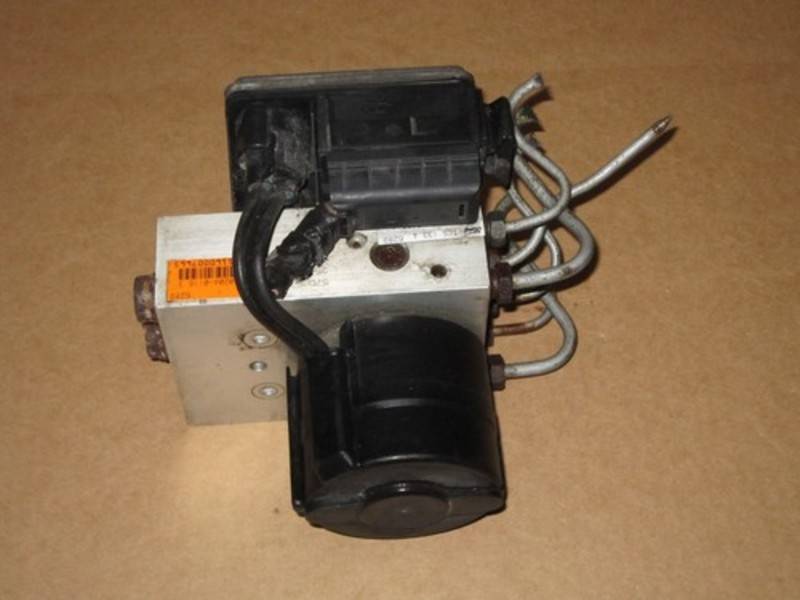

That is the ABS servo I believe....

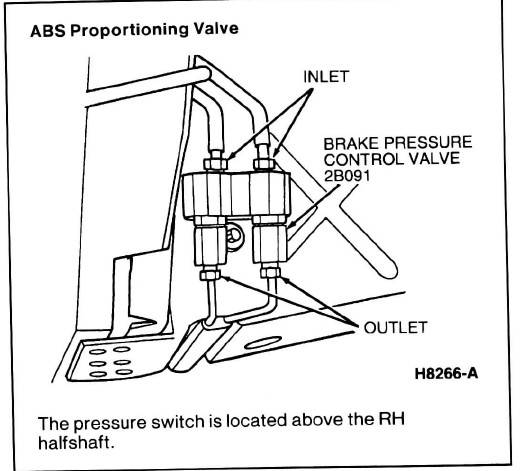

I'll look at my service manuals later and see what Lincoln considers being a proportioning valve.

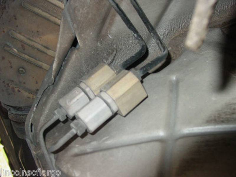

I think someone should call the guy up & have him join LVC. This way he can chime in on his situation. Maybe a picture of the part.
The picture of the mustang is a combination valve. The MKVIII has 2 seperate prop valves for the rear, because it is a crossed system. One M/C piston does LF/RR and the other piston does RF/LR.
