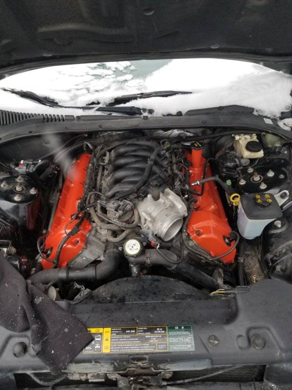

Runs fine until revved past 3k rpm, has new timing chain tensioners, possible tourque converter or flexplate? I replaced the plugs, it doesn't sound bad enough to be rod knock to me, and lifters should be heard more at idle than under acceleration, any thoughts?

Well I hooked a code reader up too it and listened with a stethoscope, it definitely needs all new coil packs and I'll also make sure to double check the gap on the plugs at the same time, I could also hear it definitely needs valve lash adjustment so that'll be alot of fun on 32 valves lol does anyone know the o.d for the shims on my gen 2 3.9?

It's a 2005 ls v8 with all the options except navigation, pics are of my car, the video wasnt I just used that video because it sounded exactly the same as mine and I couldnt get a good sounding video of my car
Well... I listened to the video. The noise is hard to pinpoint without having the vehicle present, and having a stethoscope to probe around both top and bottom.
You could do that on yours... and while at it hook up an oil pressure gauge and see what you have at idle and at 3k. If no change in pressure then your oil pump is bad and most likely the top of the engine is starving for oil.
In the video of the Gen 1... in the background behind the knock/rattle... I heard a buzzing sound that sounded like the timing chains/tensioners. While yours may have been replaced, that doesn't mean there is not an issue with the top end of the engine.
Since you think there is alot of noise in the valvetrain... and IF the oil pump is weak... then the bearing surfaces for the camshafts could be worn which would cause excessive valvetrain noise that would make it seem like the followers need a lash adjustment.
So at this point, (without the vehicle in front of me), I would suspect cam rattle due to excessive wear of the cam bearing surfaces due to a weak oil pump... but I'm probably wrong.
Also... I recognize your LS by the red valve covers. It used to belong to a member of this forum. It was at least a couple years ago... but IIRC he painted them when doing his VCG's. He may have done secondary tensioners too.
