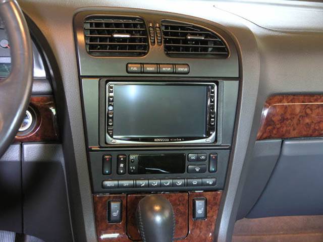

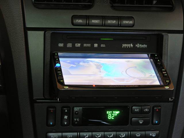

That’s a good deal. I wonder how old it is? I’ve had mine for a little over a year (with no problems), so it can,t be much older than that. I think this unit has been out for a about 1.5 to 2 years. Here a some pics of mine.
"olly00" yours looks sweet hope mine comes out as good as yours... how did they modify it? do u need a special harness or something or did you cut your old stereo? also do did you modify it so u can watch dvds while driving... i would really appreciate any input... actually alot of it! lol if you paid for it as well how much was it? for the install i mean
I have a good friend that does a lot of stereo install. I helped but he knew how to do everything. There is nothing factory used in this install. I had all new monster cable ran through out the car with Diamond Audio 6.5 M series speakers in all doors and a JL 12W3V2 in the trunk all ran by a JL 500/5. The DVD was hooked up to view while driving. The screen is so amazing you'll drive off the road if you try to watch and drive - not recommended.
i meant regarding the oem stereo face plate as in the the one the heckler has urs and his are very similar almost identical.. that is what i meant... because on each side of the monitor it looks like factory oem plastic so i was wondering if that was cut
The face plate was pulled from my dead factory HU and the opening for the double DIN was routed out. PITA, Very difficult to do. How ever many factory face plates you have is how many tries you get to get it right. TAKE YOUR TIME.
You could try to use the face off of you factory HU but that would ruin it if it works. Maybe you could check a junk yard.
