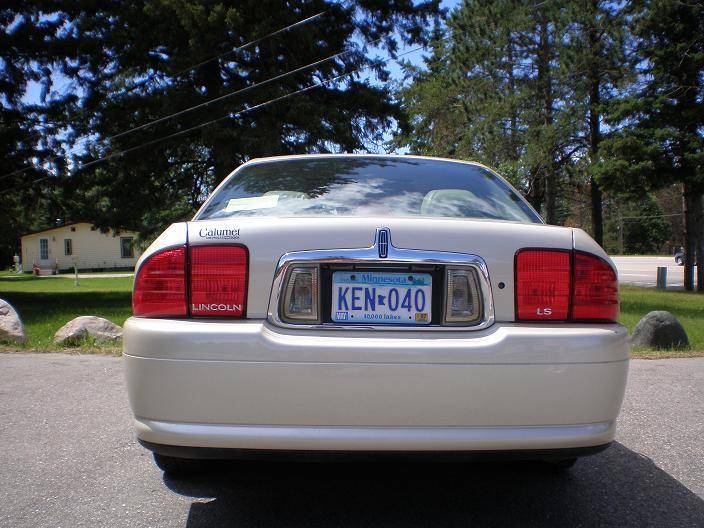

Anyone have a shot of their rear bumper? Preferrably a stock one so I can photoshop it on there.
Thanks.

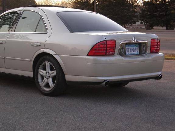

Here's a pic i took right after I bought mine. Since all the exhaust is on hangars, wouldn't that rattle against the bumper? I thought it was all supposed to hang freely to prevent vibration.

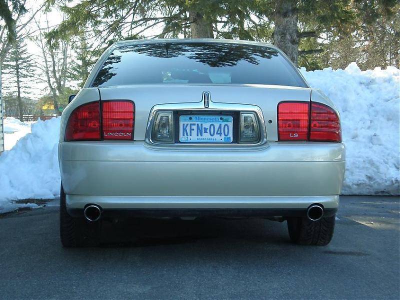

And since I'm proud of the new tips I did... this is what it looks like now :D
Sweet! Dang, I'm starting to think they probably won't work too well on a stocker. :( How did you cut your bumper? Which tool?
I used a cutting wheel on a dremel for the lower black valance. I used a jigsaw on the actual bumper. Of course, I put blue masking tape over where I was going to cut, and drew it first on the masking tape. I did touch up with a sanding wheel on the dremel, and finally with a set of files.
