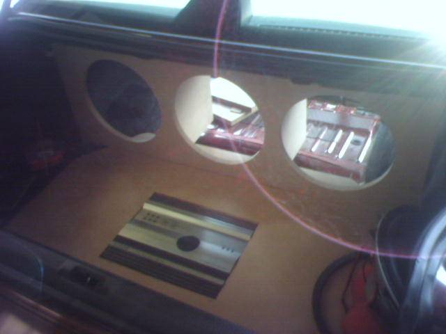

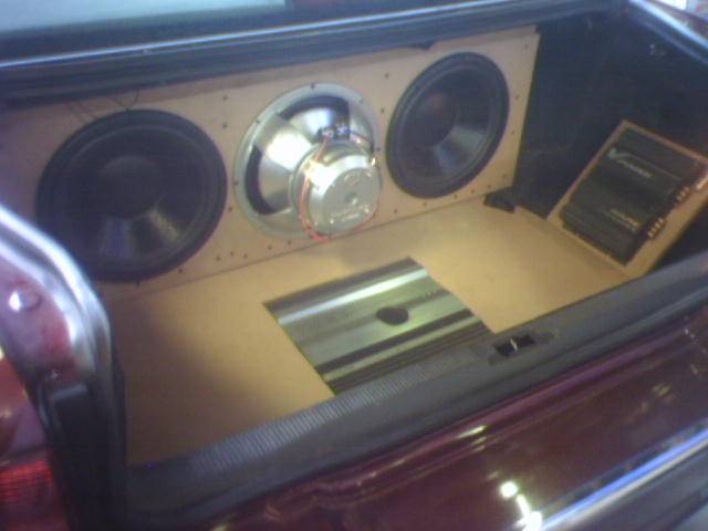

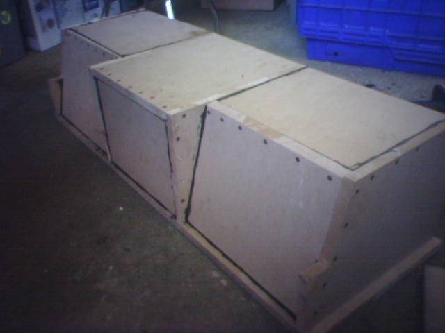

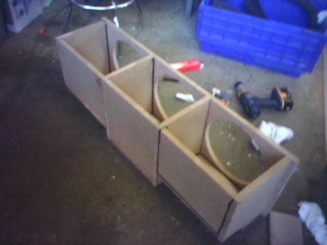

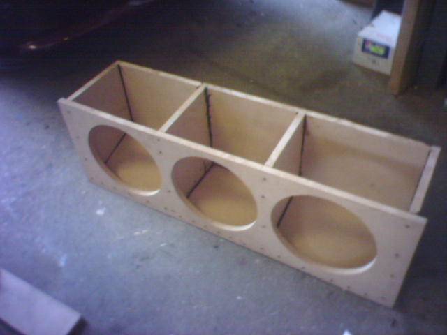

i got bored at work so i started this.

its not all that heavy acutally 1 sheet of mdf and the equipment. and there still some trunk space. I made sure I left room behind the seat for grocery shopping, cleaning chemicals and my kids crap. The main thing was making sure I can still get my spare tire out without a fight. in the next few days Ill have some updated pics and specs if anybody needs. Thanxs for the feedback

If you want it to sit all the way back, put about a 70 degree angle on the back, instead of 90. Make sure it isn't taller than 12", and no wider than about 30". That should make the box sit back there nice. With 2 10's, you shouldn't have a problem with the box covering the spare opening.

Use 3/4" mdf, buy it at like home depot. The only problem with making it the width of the trunk is clearance with the trunk hinges. If it fits, than go with it. You probably want about 2 cubic feet of internal volume in the box, but check the specs from the manufacturer.
As far as actually building it, make a mock up out of cardboard to make sure it fits, and remember to seal the inside seams with liquid nails or silicone.

well the ports depends on what kind of speaker your pushing. the depth was like 14 inches. I tried to keep it square. plus I have some storage behind the seats which was kinda important. it hits pretty hard for crap mtx's im gonna run 3 planet audios. I just did the eq and cap today. ill post more pics soon

As far as the depth, you'll probably want around about 10". Since this is your first box, just make it plane old rectangle.

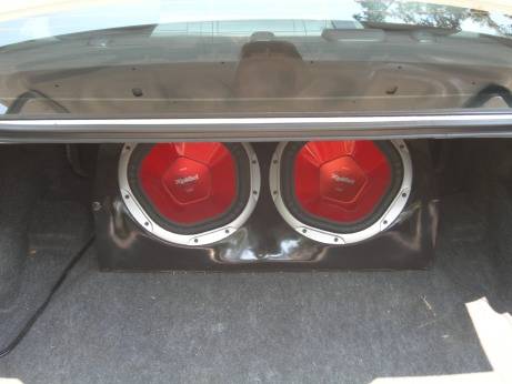

I posted a pic of my box, it took about 3 weeks to do it pretty good. It could be better if I prepped it a little better.
Good luck, and if you need any more help, just let someone know. Motts is a great source on audio, as well as 2k2ls.

anyone can build a box. just start with cardboard and tape. you can mock the whole thing up. a nice jig saw never hurts. no bs tho I spent $29 on the jig saw and $26 for a 4x8 sheet of mdf. its WAY more cost effective to do the box yourself. so far between the box and the bottom piece ive only used 1 sheet ( and thats with errors) for the circles i have a friend who builds counter-tops so he made a template and with a router cut the perfect circles for me
