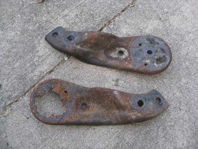

what are these called?
and who has a set for sale with little/no rust.
mine are shot.
those are rear sub frame mounts, they hold the front of the IRS cradle to the frame of the car, i have some i believe i will double check in a little bit.

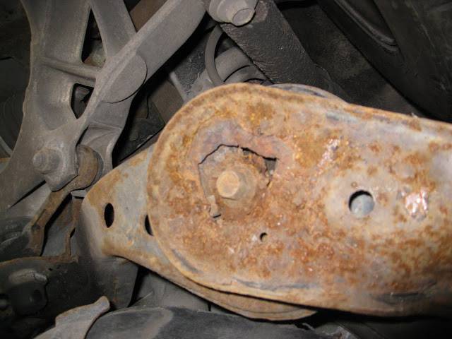

On my car they where not even there! I got a set from Jamie and they looked frekin brand new. I had to cut holes in my frame area cuz the large bolts broke or the internal nut just spun. So alot of work just to replace those for me.

they were getting there.
and i was worried about that nut-sert up in there, but it went smmothly.
broke one of the other little bolts though. :( mush easier to replace at least.

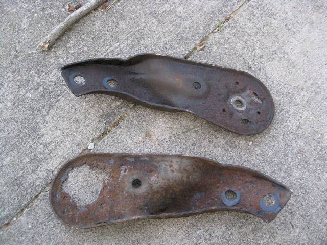

i replaced my drivers side 2 years ago, it was completely rotted, my passenger side is like new for some reason.
i now have coated mine in anti rust spray.

Ford still sells these new as well. I bought some before I realized that I can't get the bolt out of one side :mad:
*...looks for an inch and 3/4 hole saw*
