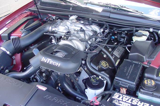

B BlackIceLSC Dedicated LVC Member Joined Apr 9, 2004 Messages 510 Reaction score 9 Location Windsor, Ca Feb 15, 2005 #6 no. The 93-96 Mark VIII engine is the same. The 97-98 Mark VIII engine uses a different intake, and IMRC set up, as well as switching to C.O.P. 93-96 Mark VIII engine(only the words on the beauty cover changed in 95) 97-98 Mark VIII engine(97 had the alternator cover, 98 didnt) Yes folks...these are both MINE!!! :give :dancefool :woowoo2: :gr_hail: :wrench :L 'S!!!
