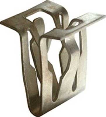

I'm taking about these. There are two of them, one on each side, attached to plastic tabs. They are what keep the vent trim in place in the dash. I'd be happy to glue and clamp the plastic tabs, but mine are just plain gone.
If someone could measure the length of the plastic tabs for me, I suppose I could try to make my own.
here one thing i've tried before on a different car but the same problem.
go to a junkyard and pull any random trim piece with the same kind of clip (a large percentage of american and some japanese cars use them and usually at least ten years old). it works better if the panel itself is thin and flat.
cut the panel up, basically cutting each clip loose with about a one square inch of base that the clip post is attached at. then use a strong epoxy to adhere the new donor clip on to your panel in the proper spot. use a dremel to trim as needed.
