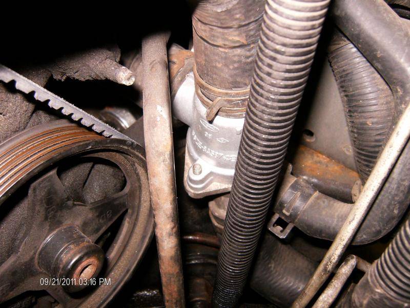

thanks to both of you for the assistance, now i just wish i would have asked earlier, oh ya i had one more question pertaining to the thermostat, are the two bolts that hold the housing together suppose to be pointing down towards the ground, cause i also installed a jet performance low temp stat but my guage is reading the exact same.
The bolt heads on the thermostat housing should be at the bottom. Changing the thermostat, without changing the tune, isn't going to lower the temps unless the car is moving, as the fan will still try to maintain the stock desired temp (210 degrees).
