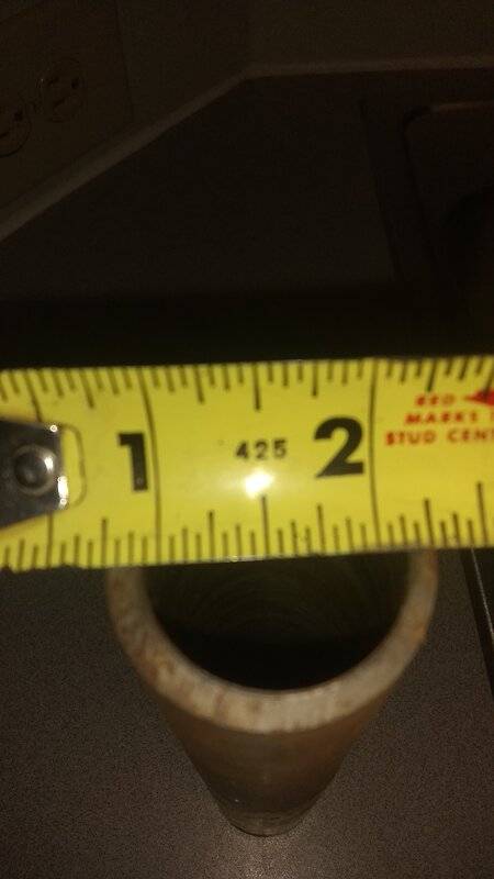

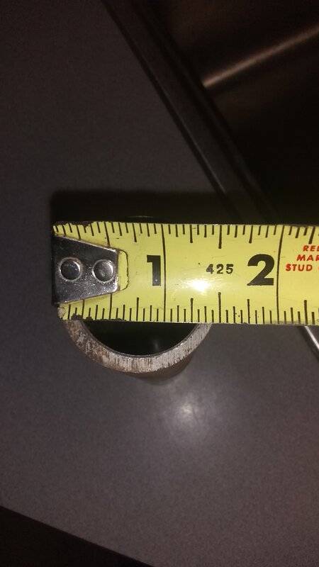

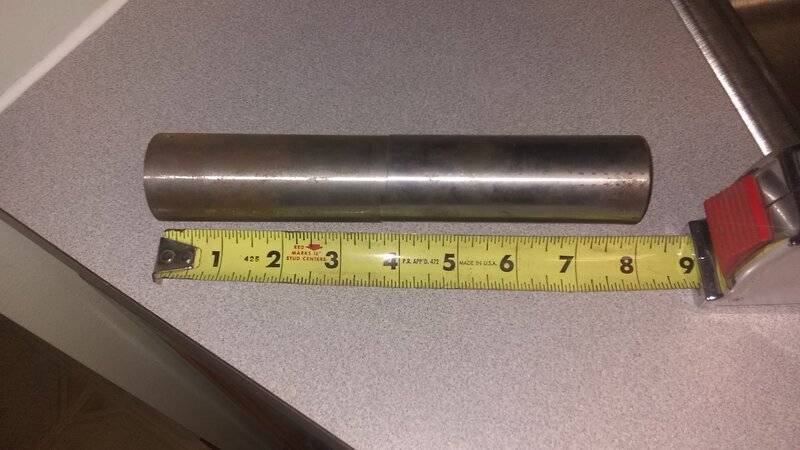

To drive the new bearing on... I just took a piece of high strength tube with 1.5" outside diameter, and 1-3/16" inside diameter... about 8" long... and drove the new bearing on.
