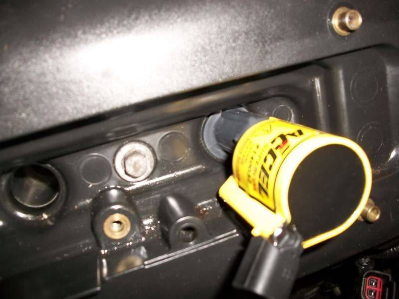

Hey guys,
Need some help. I was trying to put my Accel coils on today, and just to be sure tested if there was any danger of water getting in and messing up my coils. Well what i found was alarming:
I'm getting a good amount of water leaking in. Particularly in two spots; right over coils. Im not sure exactly where the water is getting in but i think it has to do with the rubber piece/seal that contours the windshield.
I had my windshield replaced about 2 years ago, and i was never completely happy with the job. I'm wondering if that had something to do with it?
any thoughts on how to fix it? should i just take it to some glass/window place? or could the leak be coming from somewhere else? cowl?

Mine does the same thing, not that bad though. Ever since I took everything apart to replace the degas bottle its did it. I had no idea you could buy just the seal
You can buy generic foam sealing in a roll from an auto-parts place for very little and be sure there's enough area covered to stop a leak like that! And the use of Mustang plug boots will seal each of the plug silos.
KS
KS
+1. I used the mustang boots and they work perfect
