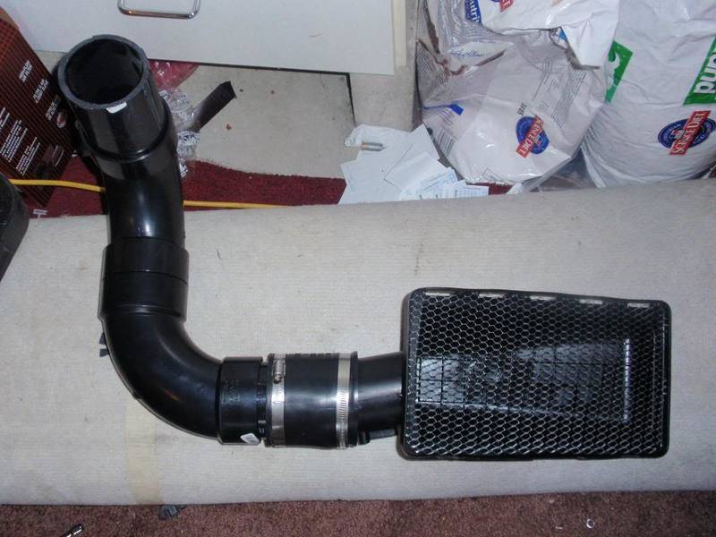

hey I remember seeing a tread on here a guy used the top of his stock air intake box and used it as a filter type thing in front of his lower bumper to let cold air breath to the air filter
now I made something kinda like it really cheaply made and no i'm not gonna have the tape on it when I really make it, just wanted to show you guys to see if you think this would work or help
you guys have helped me a bunch and I thank you

I guess it would bring up some air, but you would get better flow with a smooth tube. YOu have the right idea though. The stock air box seemed like the best way to go because it has more surface area to catch air with. You're not going to get crazy gain from this either. You just feel a little smoother pull like on the freeway when you down shift.
Putting the filter down by bumper opening will get you more and you'll feel the pull a little more.
Beat me to it ^^^^^
The tube you are using is not smooth. You would think it wont matter much but having a smoother path for air helps a lot with its flow.This is what I made a while back and it's currently not on my ls. If you want to go even smoother, you can make somehting like this and take it to a muffler shop to get 3'' pipes mandrel bent into this shape to make it a one piece, but it would cost you a lot more than what this will run you.

No problems with it. In this case you're doing what scjmc said. You can also move the cone filter down to the lower grille with no problems. I tired it a few weeks ago and it felt more resposinve and quicker on the freeway when you floor it

I would do one of 2 things. Remove it in the winter, or get a cone filter with a sock. I've thought about the filter with the sock, but sometimes driving a lowered LS in the winter is like driving a snow plow.
You definitely want it nice and smooth on the inside. And keep the opening as far forward as possible yet high enough to not have your engine act as a shop vac when you go through water.

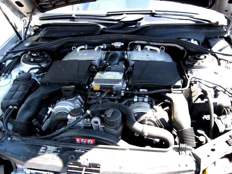

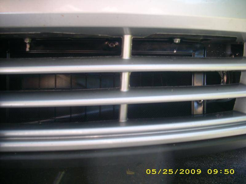

The picture is a little deceiving, but the actual intake openings are right under the radiator support cross member. Very high up, but still gets the best of cold air.
Of course, we don't have to worry too much about real cold air here, that's what the Air to water intercoolers in the back are for.
But you get the idea.
Yes, that is the venerable M275 AMG Engine. No, it's not as dirty as it looks, so lay off, KK.

So thats what a stock 600hp turbocharged engine looks like.
