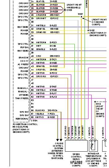

yeah, no kidding. Can I hook it up to the speed servo or does a wss a better idea? see diagram.
I'm always kinda iffy when it comes to cutting into a factory harness.. I have to do it for my IAC and I will dread every second of it.. I would just use the kit Joe posted
