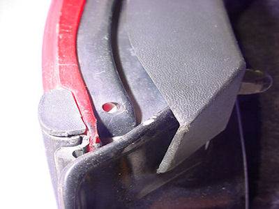

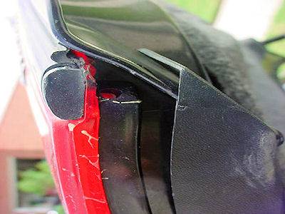

Instructions and photos by Richard McCarthy glitchm@hotmail.com I purchased his repair kit for the ballast and it works great. These instructions and photo's came with it.
This can be done by drilling a 1/8 holes in each lower corner of the light assembly. (Light assembly does not have to be removed) Drill through the light assembly as close to the black plastic backing as possible.

THANKS A LOT, THATS JUST THE INFORMATION I NEEDED!
in my experiance and others drilling holes always allowed the moisture to come in, but i dont know i guess it worked out for some......good luck, id just takem apart.
I always thought the same, that holes would invite the moisture but, since I drilled the holes last November, I have been moisture free. I think the real test will be when the humidity reaches that nice balmy 87% here in NH in August. If it stays dry, I will be a confirmed believer. I have a moisture problem with the fender mounted tail lights and they have moisture in them still (some days they are like little tiny ice cubes rattling around), I can't wait for the weather to warm up.
