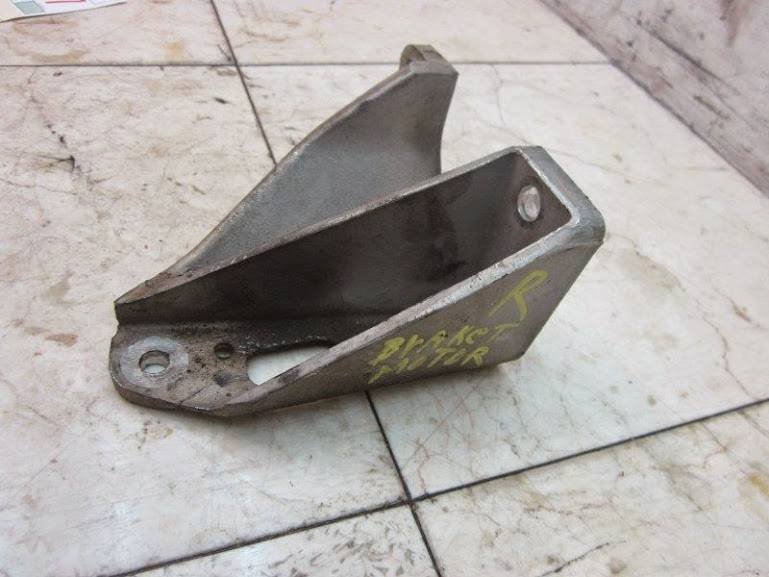

But, trying a different approach, I searched for a mount for a 2000 Jaguar S-type, since the engine is the same as my LS. Found a bracket on eBay that looks identical to the pics from the parts diagram. Overall dimensions and hole locations will be key, of course, but so far this is as close as I've found, so for $29 and free shipping I went ahead and bought it.
This is the bracket I just bought on eBay.

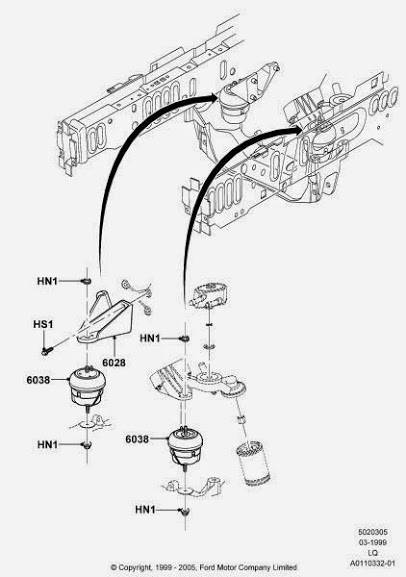

And here is the parts diagram:
Looks like the right side motor bracket to me...

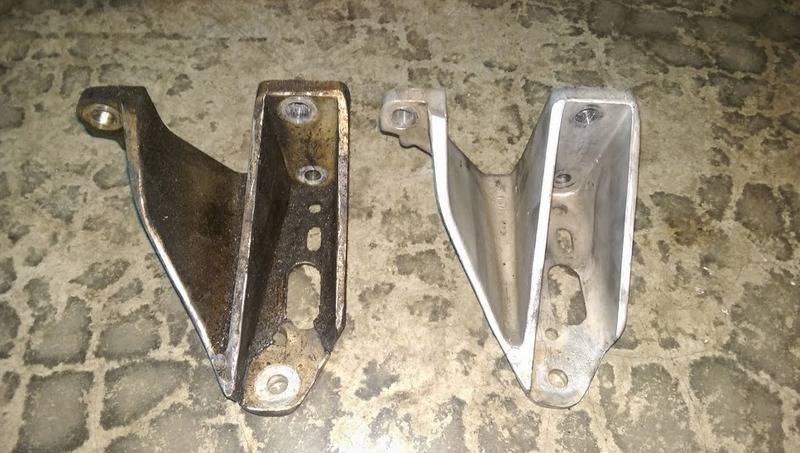

I can now confirm two things related to the motor mount brackets:
1. The V6 and V8 motor mount brackets are not the same.
2. For the V6, the LS and Jaguar motor mount brackets are the same. I think they're even still making them for the Jags.
The bracket from my LS is on the left (think I have an oil leak?). The Jag bracket is on the right.

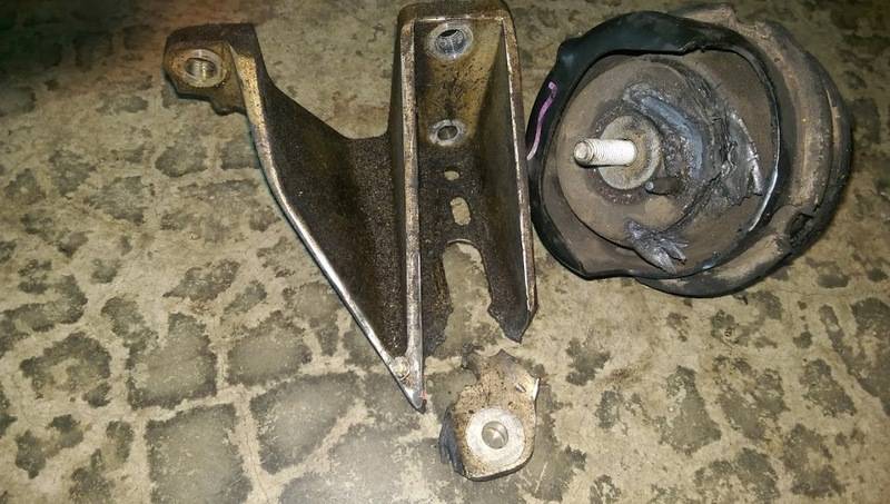

And, just for fun, here's what the break looked like and what the pointy metal did to the rubber of the mount.
The good news is, having the new motor mount installed has taken the shake out of the vehicle while idling in gear. Next will be the valve cover gasket to stop the oil leak. But, overall, not bad for an $800 car.
