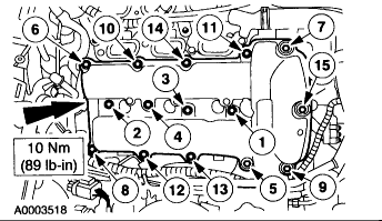

Any V6 owners here perform the valve cover gasket job more specifically the Right hand, passenger side, valve cover gasket?
I am looking at the prospect of doing this myself but cannot find the full details on alldata.com. It seems their instructions for the RH VC gasket removal seem too easy. IIRC some folks have stated that much of the intake has to come off.
Can anyone add to this. I am ready to do the work and after this christmas and 3 hurricanes I could use an opportunity to save some $ and really need a distratcion.

I found the removal and install step for the intake. it definitely gives a clear shot to the valve cover on teh RH side. Looks like I am going to need a big parts list as there are gasket on the intake that might be damaged. Plus I am wondering if I should go ahead and replace the EGR and PCV since I am cutting past those as well.
I would definitely appreciate some feedback on the replacement of those parts from you all that are in the know. If it isn't broke don't fix it or does it make sense to replace them since the coils are all getting replaced on both sides?

Got a question for the crowd it is regarding a procedure in alldata.com:
Apply a 5 mm (0.2 inch) bead of Silicone Gasket and Sealant F7AZ-19554-EA or equivalent meeting Ford specification WSE-M4G323-A4 to the front cover joints.
They say apply a bead of silicone gasket and sealant... are they refering to the gasket(s) and do they mean put some sealant on the gasket(s)?
I am sure this would apply for the V6 or V8 anyone have idea?

As for the sealant, I think it is supposed to be put on the valve cover, gaskets are then placed on the valve cover, and finally you can bolt the assembly back together. This is what I gathered from other cars with the same gasket replacement.
Thanks, unfortunately, or fortunately depends on the perspective, I have never had to do this sort of repair before so I am not sure how to handle the application of the gaskets.
