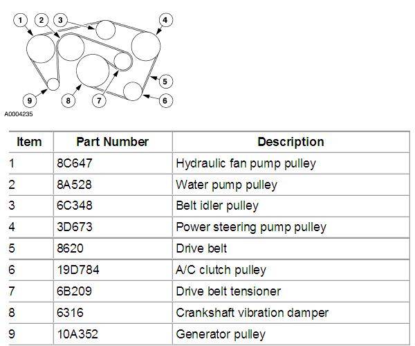

I cant find anywhere that shows the belt routing for the v6.....my car is on the side of the road and I need to get it going so I can get to work Please someone help me I dont wanna loose my job.....
thanks
Dustin
Man, I don't have the routing diagram, but the left side starts from the alternator and the right one goes kind of all the way down. You have to squiz the belt through the tenshioner.
I did it some mine about two months ago and had hard time puting the belt on.
Good luck.
Accessory Drive
Component Locations —3.0L

SO after trying for about 2 hours in the rain with no luck I got towed 3 hours later and the garage chaged it in 10 mins and cost me 30 bucks....now I was driving home last night after the football game and I here what sounded like firecrackers....i pop the hood the bet is shreading again....WTF!!!!!!!!!!!!!!!!!!!!! Help why would it be doing that????
Maybe one of those tensioners (I don't know how are they called) are messed up or crooked and it keeps poppin your belt.

Firecracker sound that's odd? I had a similar problem with my previous car, like mentioned above, it turned out to be one of the pulley wheels - the one on the tensioner. It only cost me like $7 and was a simple fix - on that car. I replaced my belt on the LS and it was a little difficult because of where the belt is placed. Also, I borrowed one of those belt tools from autozone. Make sure you remove the air filter hose and be sure to make sure the belt is aligned properly. The other thing I found uneasy was getting the belt centered correctly around each pulley wheel. If not, it will zig zag. Definitely inspect each pulley wheel and the tensioner though. Next time, I'll probably just let the dealership do it for all the trouble.
definately check the pulleys.. I had that once and it was an idler pulley that siezed, but I believe that tensioner pulleys are more common.
take the belt off and try to spin all of the idler/tensioner pulleys by hand
