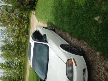

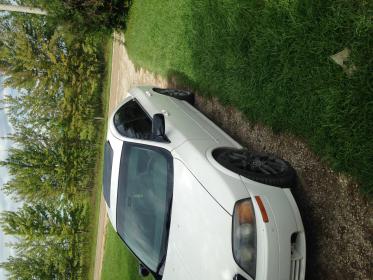

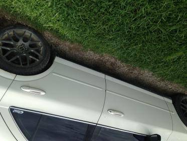

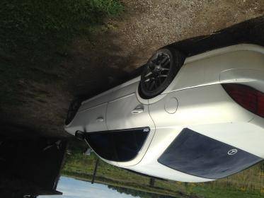

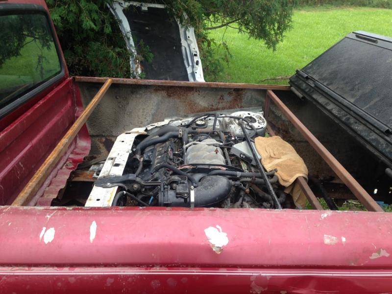

rite now i have a the intec 32v motor running with or without its factory auto trans... now it took alot of wiring and what not but i figured if the ranger project didnt work out i could easily swap this harness and motor into anything.... so i heard this intec 32v trans pattern was the same as the jag v6 rwd trans pattern.... and thought.... i have a 01' lincoln ls v6 5 spd standard. if they are the same transpattern then i want to use the original tranny for the lincoln. i work at a speed shop with plenty of resources available to make the trans tougher and clutches that'll handle 1500hp for that... im sure the trans can be built to handle a little more nyways...

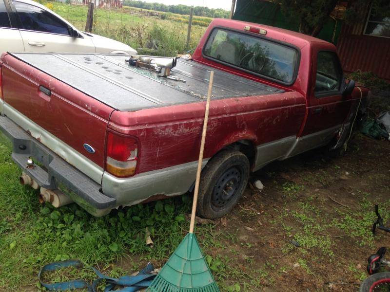

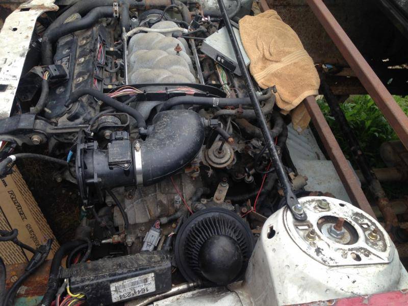

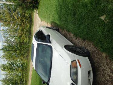

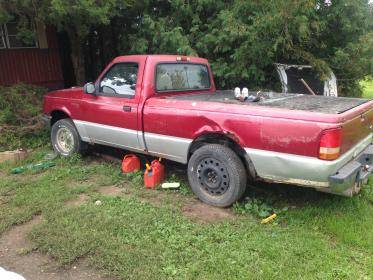

i'm not sure i believe what i'm seeing. you replaced the rear axle on the ranger, with
a front k member and complete engine ? you have a rear engine ranger ?
are you kidding me.
the fwd 4.6 bolt pattern is an awkward screwed up version of the mod motor bell housing.
its not gonna bolt to anything but the atx it came with.
