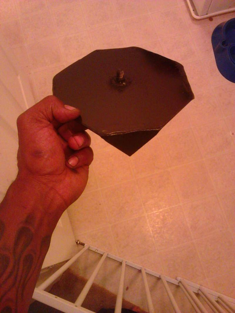

Well today I got everything to do my spring conversion from a mid 90s V8 Bird. I got the setup for less than $80. The spring perch materials cost me $8. I bought 4 pieces of 8"x8" 1/8 steel plate. I followed a diagram posted up from a different sight on how to make the things. Like an idiot I made the perches at work and left the coils at home. Didnt want the bosses to know what I was up to and walking in with a big ass coil spring is dead giveaway. Anyway the plate, according to the diagram needed to be 6.5"X6.5". Well I did not take into consideration he used an aftermarket spring with an outside diameter of 6.5". The stock TBird springs have an outside diameter of 6" leaving me a half inch gap around the spring. Do you guys think they will move around too much and wallow out the lower control arm? If so no big deal I can remake them. Dont really want to but I can. Dont laugh at the pic Im not a pro just a dude with some tools.
they look nice to me and i highly doubt the spring will move at all. in fact i think you did a good thing as my perches are creaky because they are too close to the spring. i've seen cars in the junkyard with no perch at all if that tells you something. i'll trade you if you decide you dont want use them :D
I really think you're fine. I've seen Marks in the JY with no perches at all for their rear springs.
Cool thanks guys good to know. I had a feeling it would be ok but back in my lowrider days Ive seen some crazy stuff when it comes to springs corkscrewing thru control arms. Just wanted to be sure before I put this stuff in. Hammer I have some extra metal and can make you a set if you want.
