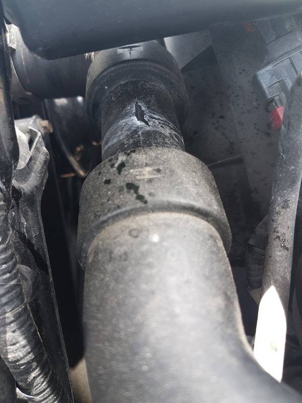

My upper rad hose cracked on the plastic portion and it's spewing coolant all over my engine -_- Don't have the money to get a new hose until friday...my mechanic suggested high temp resistant epoxy to seal the crack in the meantime.

Yes, I know. That's where it always fails. The thing is, it's not just that crack. All of the plastic is rotted to where it will fail everywhere. Fix that crack and let pressure build, and it'll just crack nearby. Of course, you could always be the first exception to this.
Hose today, degas tomorrow, radiator sidetank the day after that, DCCV, coolant crossover, thermostat, etc.
It is a decent chunk of change, but it's a lot less painful to get them all done in as few rounds as possible.

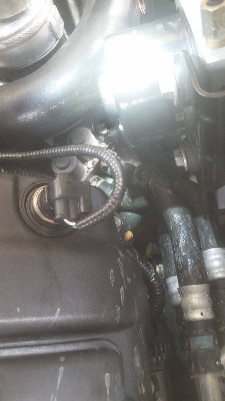

Wondering if I have the same issue. Had to add a small amount of coolant after a recent road trip - noticed splash pattern on passenger side - followed it up from back to front and could see no actual leaking fluid car running while hot/cool etc Evidence appears to suggest it emanates from the plastic side of the radiator near top
