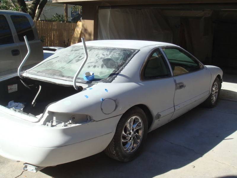

Update on the painting: *PICS* Need to know how to remove door handles.
Myco
Nov 28, 2008
913
8
Houston

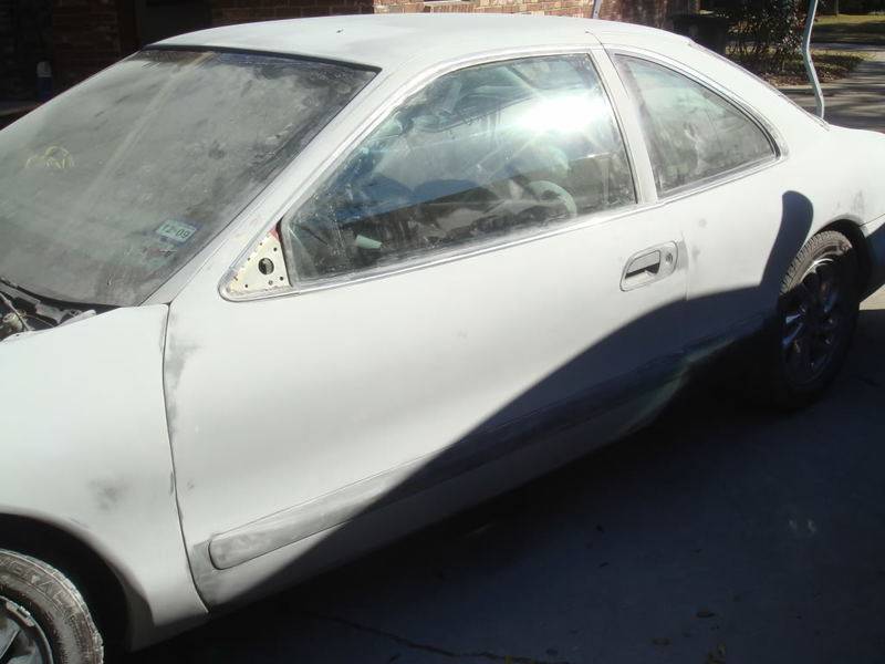

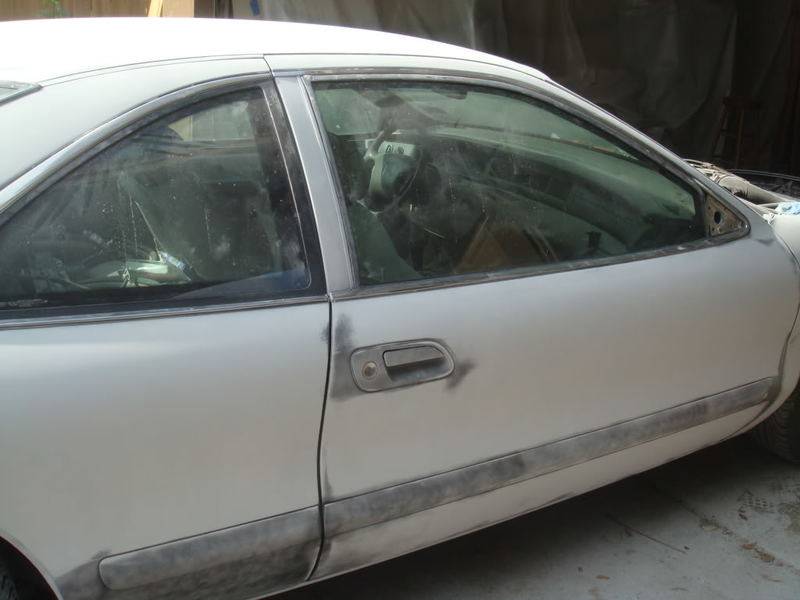

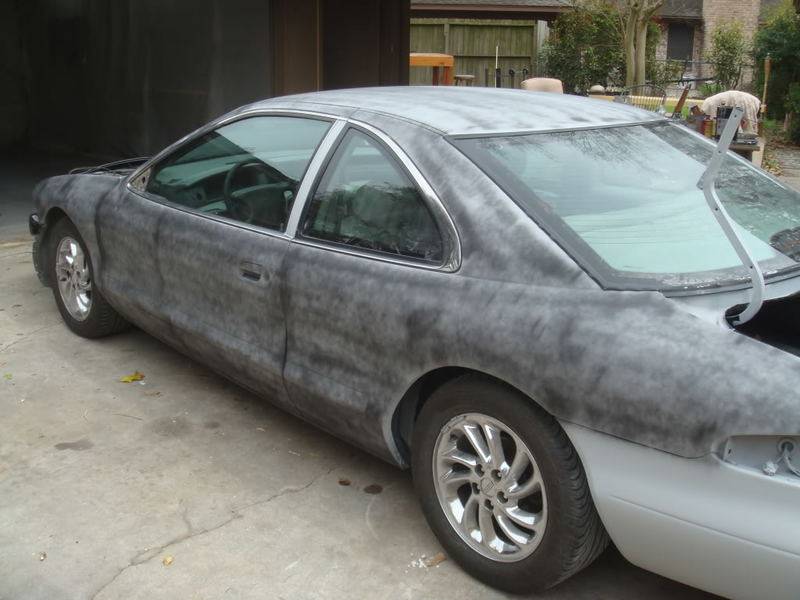

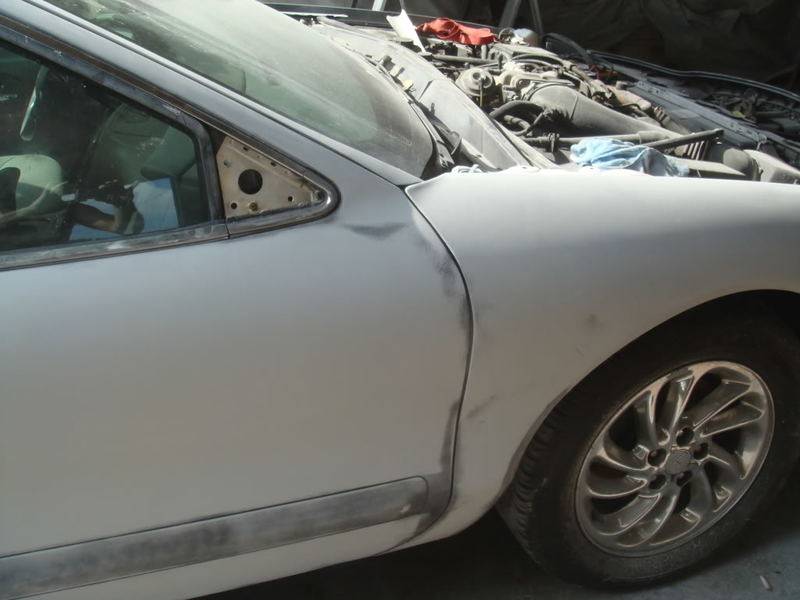

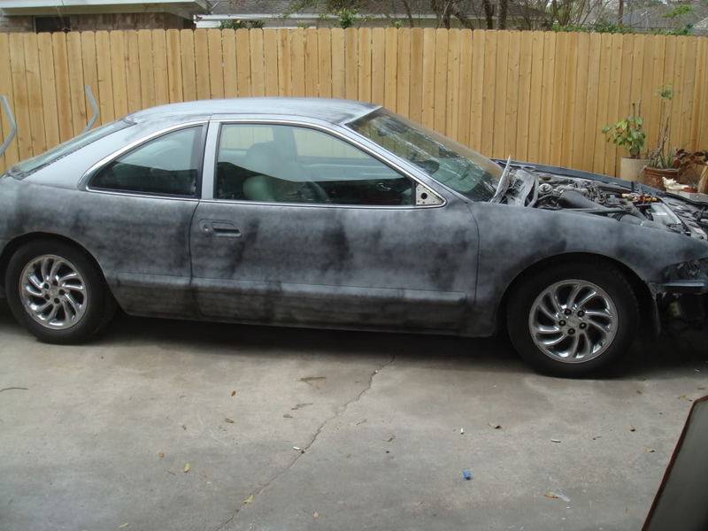

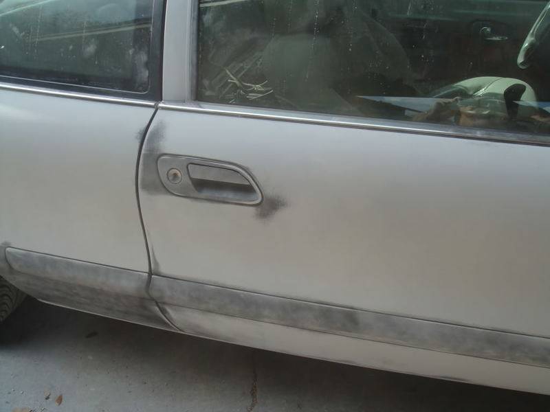

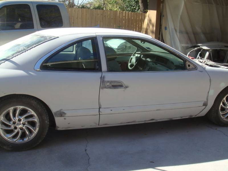

I need to remove the door handles on the car. Do they pop out in one piece. There are also some spots on the car around the hinges I'm scared to putty. Are these areas supposed to curved on the mark? Anyone ever blocked a mark VIII before?
I'm also removing the air compressor. It works. Anyone need one? Pref. in Houston. Don't know the going price. What's a fair price for a LVC member?

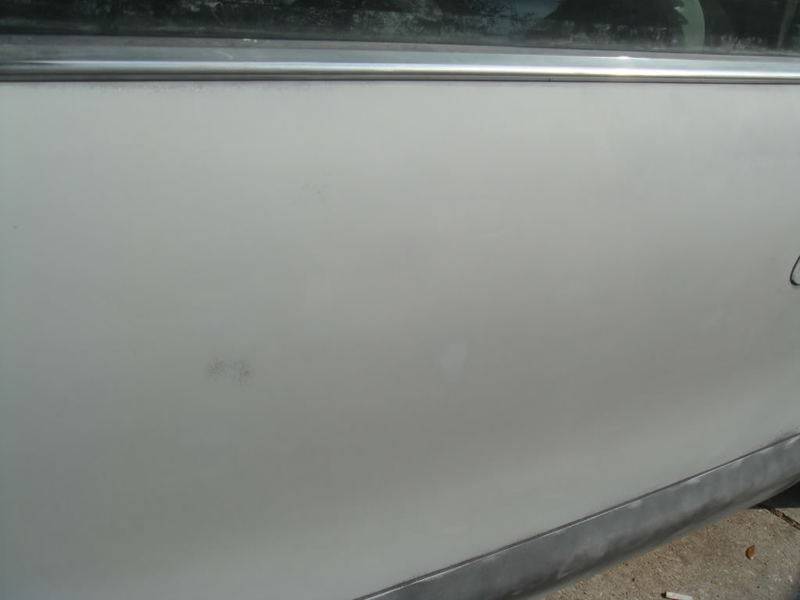

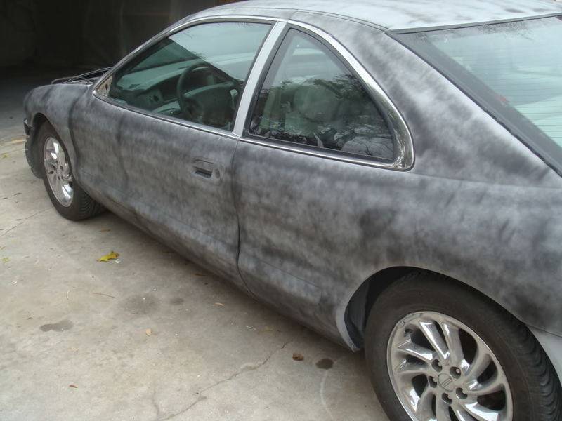

After sanding down the epoxy I put on the 2k with the new tip. This was the result and it layed fairly flat.
Sprayed the guide coat on the car.
AFfer a day of blocking.
Now:

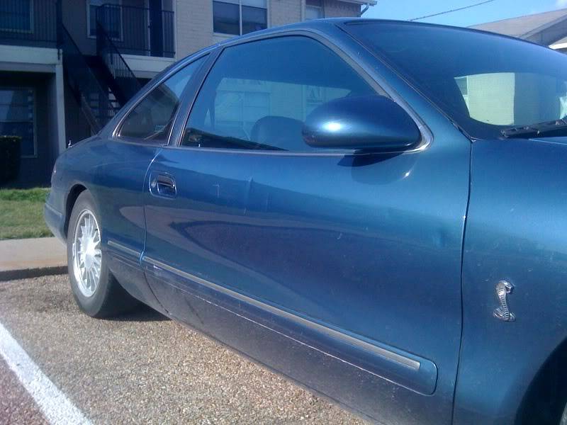

ok i just installed chrome handles on my 93 last week.. a bit of a PITA but not terrible...

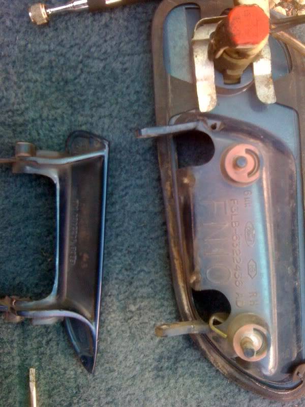

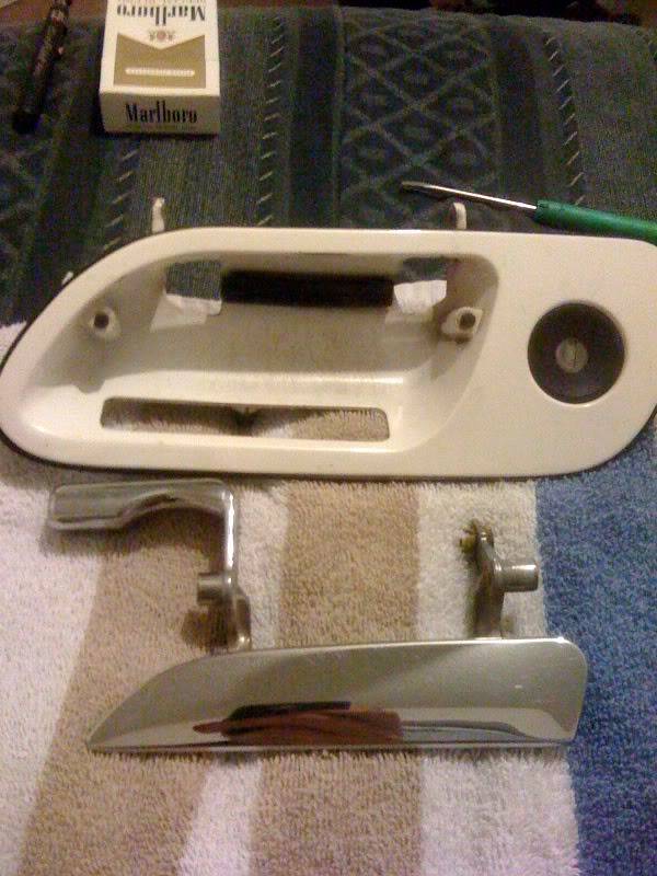

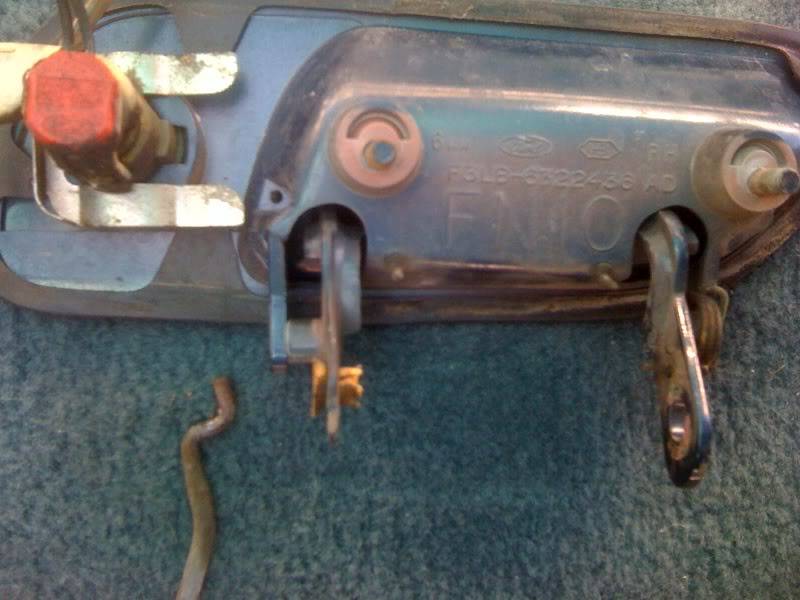

the tab toward the front of the car above the handle retracting spring is where the weigh bar was once bolted, it bolts to the outside of the handle and points towards front of car, as the chrome handles forged one mimics

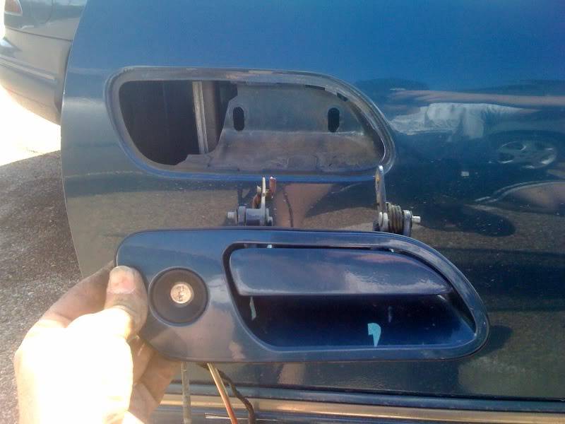

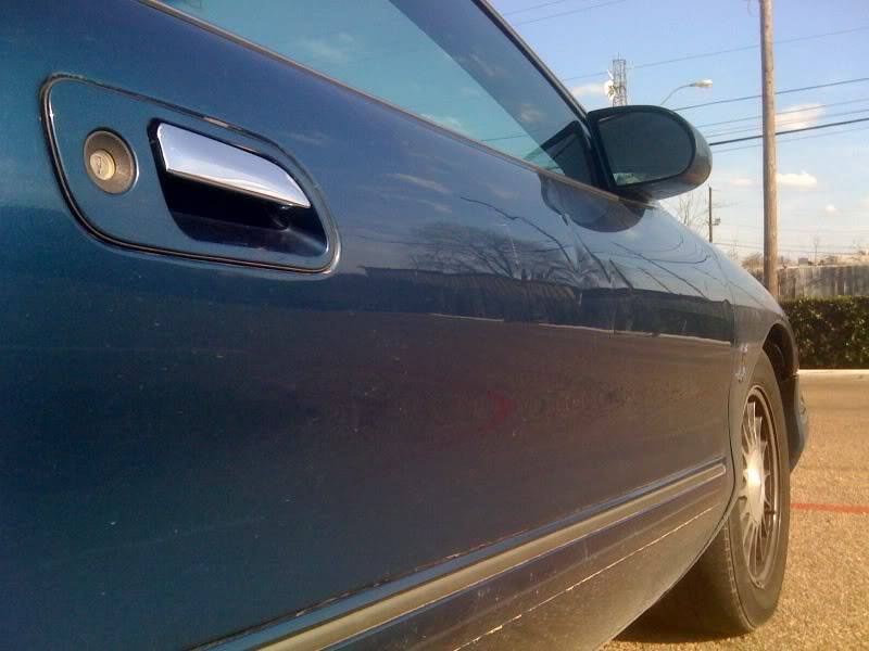

town car white housing and chrome handle, i had my paint code matched by Napa Auto Body

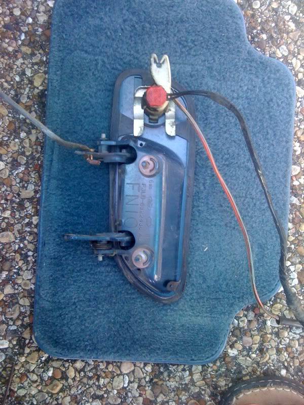

you can see the white clip here that holds the rod to the lock silinoid ( above)
on the handle you can see where the weight bar used to be attached, the chrome is forged on and shorter in length
what i came to find out, is that the Mark 8 and the Town Car have different handles, if you are replacing one for the other, the housing must be used with the proper housings handle, the hinge forges are slightly different and if you cross the 2 ( Mark handle in a TC housing or v-v , it will not lay flush with the body in the housing) the housing can be swapped between vehicles as long as the respective handle is also used
you can slighty see what im talking about in the last picture, the handle nearest the key hole sticks out a tad in the housing, and when you pull up on it, itll STICK in the up possition and the springs wont retract it into the housing
i will do a more step by step if needed when i replace the passenger side with the proper housing sometime after this weekend
Keep it going. it pretty easy DIY removing the door handle. U going to paint the crome around the window. Mite as well while ur at it cut or roll the rear fender just incase u plan on putting wide tires in back.

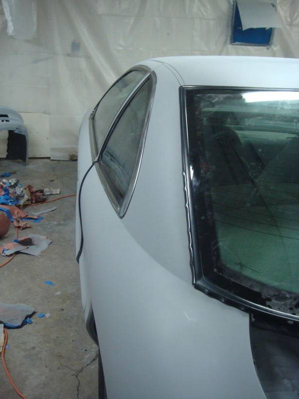

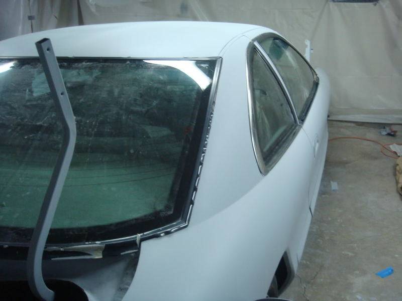

You need to remove the 1\4 glass, back glass, door moudlings, window trim, and rear bumper before painting. Otherwise in a year when your clear starts to chip you'll have to redo the whole thing again. You can get away with using pull back tape on the windshield. You'll thank me later.
I heard to do this you need to remove the entire window. Anyone have pics or a walkthrough. I'll do it if it's not a serious PITA.
Not planning on it and don't know how to do it. The back right was rusted through and I had to fiberglass the inside to reinforce bondo being put in and it has a dent outward right in the middle of the wheel well. I'd hammer it out but it causes all the bondo to break up and don't want to go through it all again.
town car white housing and chrome handle, i had my paint code matched by napa auto body
