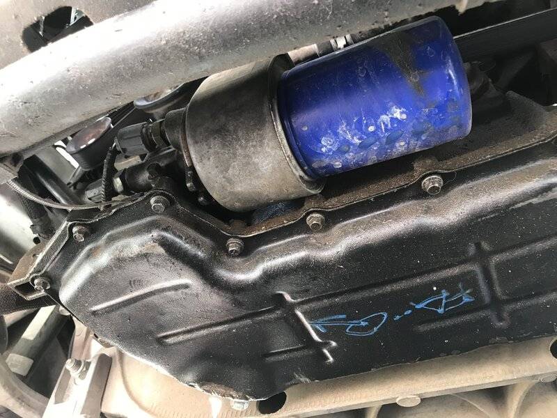

this is where the leak is dripping from. Everything above the Alternator and some below is bone dry. so the thermostat stuff and others were dry as well when i checked this morning.
nice ls looks clean under ,,
right on top of that block where the oil filter screws on theres a coolant hose or two leak might be from there

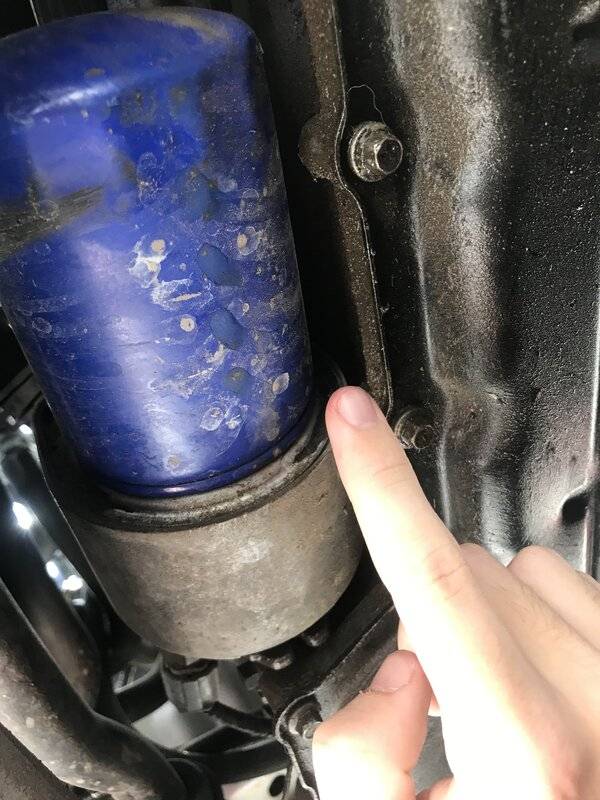

Mine was leaking from above where you are pointing. It turned out to be the water pump. Again, make sure you are getting a Motorcraft!

I still think that it is the plastics parts above, more likely than not. Still, I will also point out that the round thing that the oil filter is screwed onto is the oil-to-water cooler. It does have coolant circulating in it, but every time that I have heard about one of those leaking, it has been internally, into the engine oil, not external.
Confirmed its leaking coolant. Probably obvious but at leased i found the specific fluid. And yes the DCCV was bone dry as well and to far away too be leaking where its placed. Soon im going too get my buddy and were going too drain the oil and cheak too see if the fluid have been mixng as i don't believe theres only oil in em. My friend thinks its the water pump and somthing to do with the weep holes. Hope its not since i have a tri cooler and id rather not have too take the entire front end apart… again.

Confirmed its leaking coolant. Probably obvious but at leased i found the specific fluid. And yes the DCCV was bone dry as well and to far away too be leaking where its placed. Soon im going too get my buddy and were going too drain the oil and cheak too see if the fluid have been mixng as i don't believe theres only oil in em. My friend thinks its the water pump and the
If you have water in the oil, the dipstick will surely indicate that. The oil will not look like oil, either dirty or new, it will look like coffee with lots of half and half.
