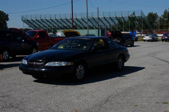

15'' wheels won't fit mark Viii brakes without grinding calipers.here is a photo of mark viii on 15'' T-bird rims

You can just buy mustang gt dual piston calipers and rotors. They clear 15s and stop better than our stock brakes. I went the expensive route and bought big brakes... I ended up paying 500 or more for calipers, rotors, front hubs, rear hub redrill, new rotors for rear, all new ceramic pads and misc brake hardware. All you really need new are hubs then you send your rears out for 75 bucks.. from there you can redrill your mark rotors yourself. Now that I know the ins and outs of it I could source parts for under 200 if you were to include gt pbr's and rotors.

yeah i kind of figured they wouldnt fit. a hub swap is kind of out of the question im trying to spend as little as possible here. anyone have a cheap set of rims/tires for sale?
