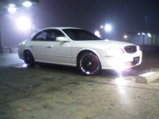

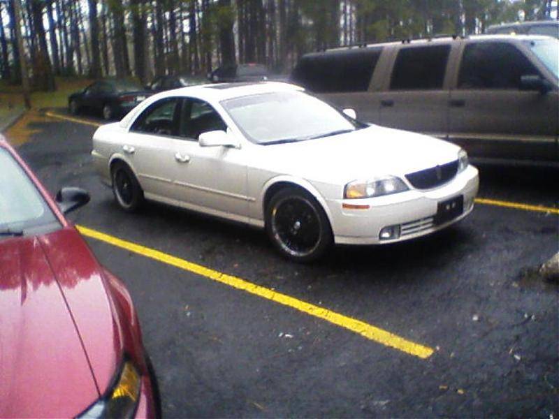

good thing that you attached those pictures of your LS becaue they dont make them for that particular white model :p :p :p :p :D
what about running a high amp alternator?...and why is this platform so difficult?...i mean i love the car, but its like its unrecognized...also, they dont make them for the white model?...aww...shucks man...what if i plaster some tacky tribal graphics all over the car?...
