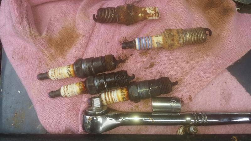

unable to get spark plug socket on plugs :(

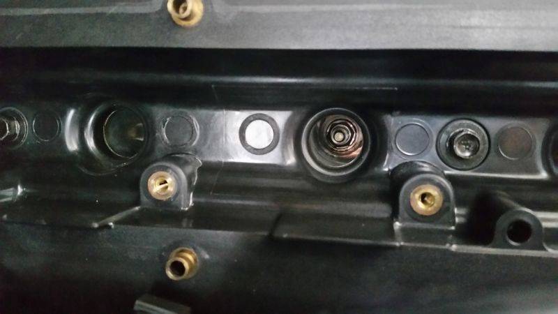

I've managed to extract the last stuck spark plug, and am now looking to remove the valve covers to clean them thoroughly, check the gaskets etc. before reassembly
I am having trouble with pulling the valve covers, seems they are getting stuck at what I presume are the cam sensor on each side at the front of the valve covers, they will lift slightly and then bind on the boot around the sensors, are these sensors required to be removed from the valve covers prior to taking the covers off? and if so what is the proper way to remove them?
Those are not the cam sensors!
Those are the VCT solenoids that control intake valve timing. You unplug the electrical connector, then you pull up and remove the seal around them (I suspect this is what you are calling the boot.). You may have to pry under the lip of the seal with a flat blade to get them started coming off.

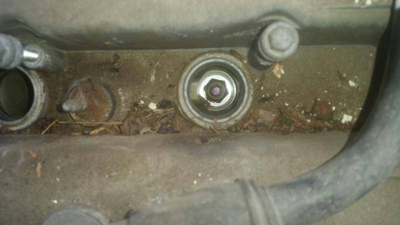

Thank you once again for the advice, I managed to get the passenger side off, I haven't taken the drivers side off yet, still have to remove what I believe to be the cylinder head temp sensor? anyways I can see now on the side I have off how the solenoids work with the cam phasers and how they are attached

Is there a special socket required to remove the cylinder head temp sensor from the drivers side or just a 19mm deep socket?
No special tool, but do note that you will have to replace it with a new one.
NOTE: The tip of the CHT contacts the cylinder head at the bottom of the hole. When removed, it will be slightly crushed. This is a normal condition.
