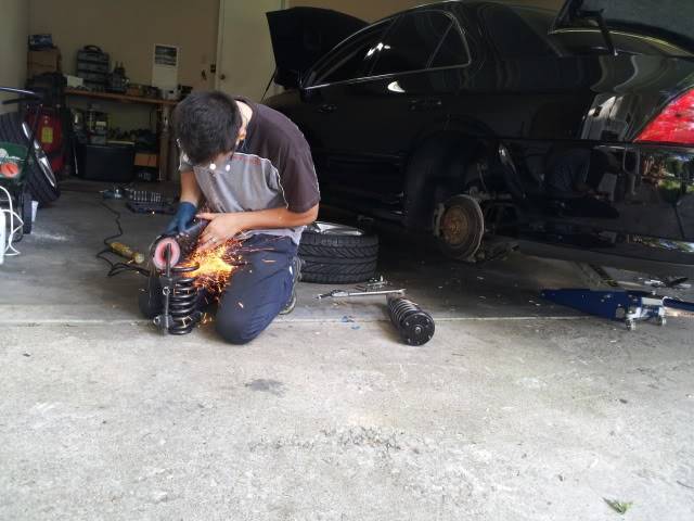

Wonder what I'm doing today?
I just don't know... :rolleyes:
lowering, lowering springs?
BTW you're brave hovering your face over a loaded spring.
I would also like to kno how it rides after cutting. And move your face lol
Haha that's actually my buddy doing the cutting. He's done this a few times. The car is almost put back together and then I'm going to clean it up and try to take pics before I go to work.
Awesome you should get us some info on where exactly he cut and how many coils he cut off. I know this isn't the safest option at times but may be the only option to go lower than 1"
Also an update on what the ride is like with your 19"s
We took off a full coil on the front and half a coil on the rear. So lowered the front another inch and rear a little over a half and inch.

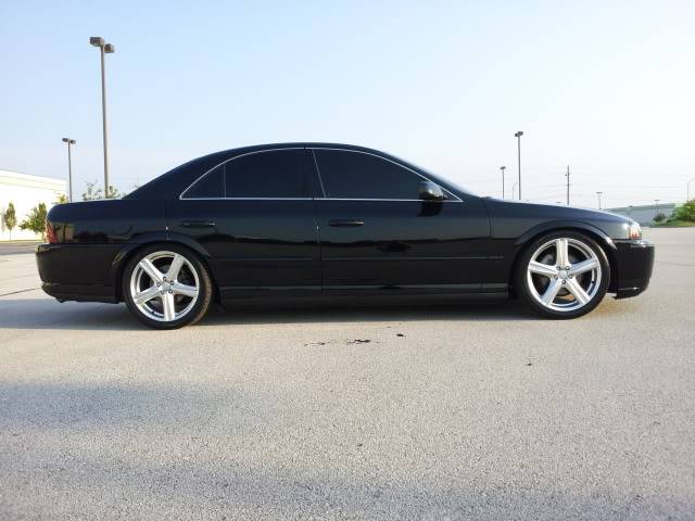

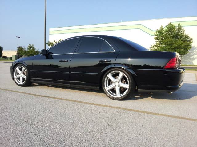

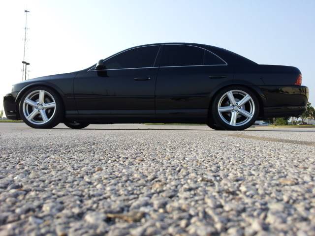

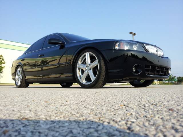

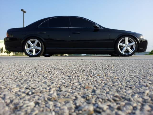

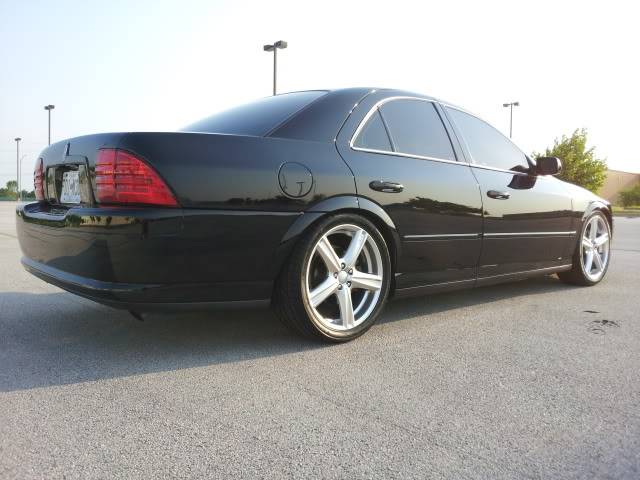

Ok guys sorry about taking so long to get back with some results, but on the bright side, I've had enough time to drive it around the last few day and see what the difference is in ride and driveability. The verdict... I cannot tell any difference. The car still rides like it did with the Eibachs not cut. I am very pleased with the results and the amount we calculated and cut off to get it right. The LS springs do taper at one end of the spring, but you cut the other end and it sits fine in the top. Also, the springs are not flat on the top like other vehicles, so that was not an issue. All I will say is that I am very pleased with the results and didn't have any issues. But you guys will be doing this at your own risk. BC if you take too much off, there's no going back. And also keep in mind my car has a different engine and transmission in it also, so the amount needed to be cut off the springs might be different on a v6 or v8 factory motor. But enough of the technical crap, here are some pics!
^ Nice I don't think anyone realized you were cutting the Eibach springs. Still need those pics! :)
