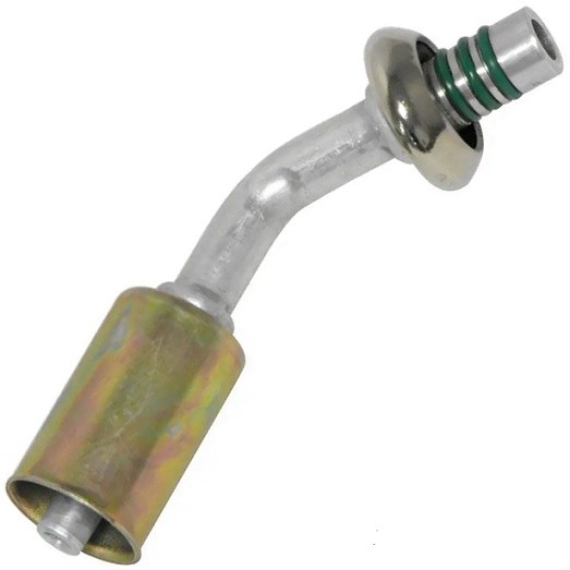

I took a look and noticed a leak where the Compressor to Condenser Discharge lines connect, this explains the A/C compressor recently cycling On/Off. Further inspection resulted in a grey(or light brown) ring that I assume should be somewhere within the spring lock clip assembly.
The workshop manual doesn't mention anything about this ring, but looking at this listing for a similar Discharge assembly leads me to think the ring belongs within the discharge tube.
What would the likely fix be: Replacing the Condensor Discharge line assembly or simply reinstalling the ring and replacing the o-ring seals?

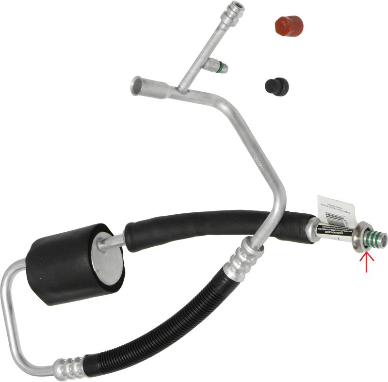

That is a spring lock fitting and the only way to replace it is to cut the metal ferrule off and re-crimp the new section on. Much better to just replace the hose assembly as your planning to do. But there are many repair sections out there if you need to do this. Here is just one of many. Also note some spring locks have 2 O-rings and some have 3 O-rings. The 3 O-ring setup is better for sure!

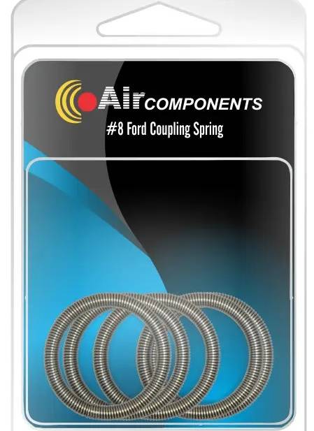

You can get the springs separately as well.

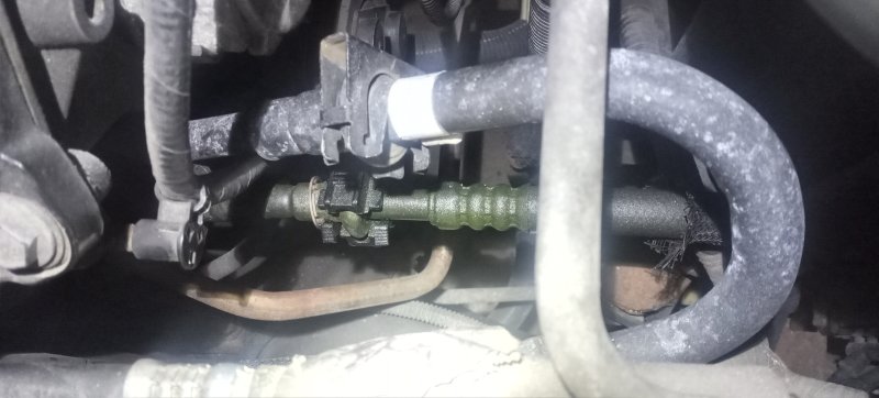

You might consider getting a few springs if you plan to try the O-ring fix first. Note there are also additional keepers you place over the spring lock to help hold them even tighter. I have never used any of them.
