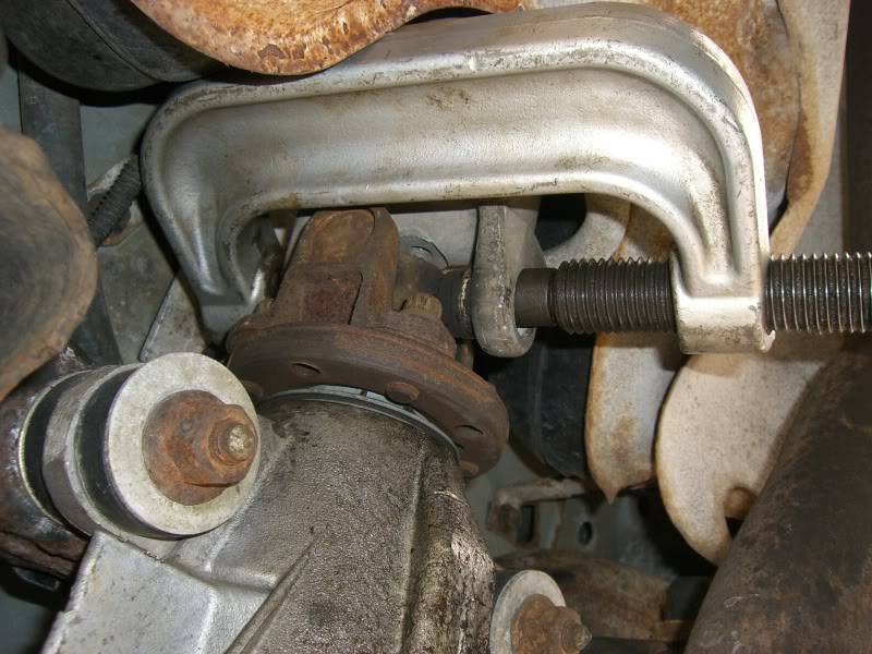

I did mine in car with exhaust dropped. The front u-joint was out so I could slide the shaft forward to do the rear. Then I went back to the front. I did not think it was hard to do at all. I used C-Clamps to do my joints, maybe that helps. Sockets from a socket set to help press where the lip and clamp meet (since the caps are sunk in). Never dropped the tank.
That sounds more like it to me :D
How do i remove the bearing caps?
I remove the c-clip/spring things with a needle nose - if you are lucky. What I usually do is bring out the c-clamp first. Then I use a socket to push on one side inward. This moves it just enough to get the retaining clip out if its stuck. What the heck is that called anyway?
When one side is free of the clip, I just use the clamp/socket to push on the other side to get it through and then the cap can come off.
I hope that makes sense. But if you do the front first you should be able to get the rear one without too much trouble. I know my exhaust was dropped in the front only, still on the rear hangers. And I know the tank was in place. There is not much room to work the rear, but since you can now move the shaft forward for installation its much easier.
Another method that some have done is to unbolt the shaft to diff interface. There are several bolts. I think they are torx type. I almost tried that method but could not get the bolts free.
I went and rented a ball joint tool from Autozone and did my rear joint in the car.

So I got the car up on jack stands, lowered the front of the exhaust, marked drive shaft position, and removed the u-joint clips on the front joint. I took a socket that fit in the clip hole and put a few extensions on it and beat it with a hammer. The thing didn't even move a bit. I became very frustrated, so i put everything back together. I had enough room to get at it, just wasn't able to get the old u-joints out.
Get a c-clamp or borrow the correct tool from a parts store. A clamp will generate much more force than hammer.
