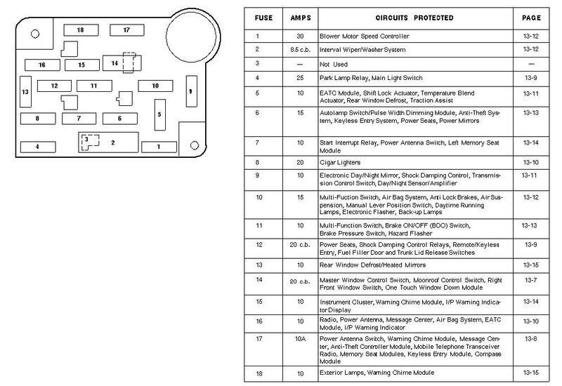

sounds like you need a new multifunction switch.
check fuse number 10 and fuse number 11 on the interior fuse box.
