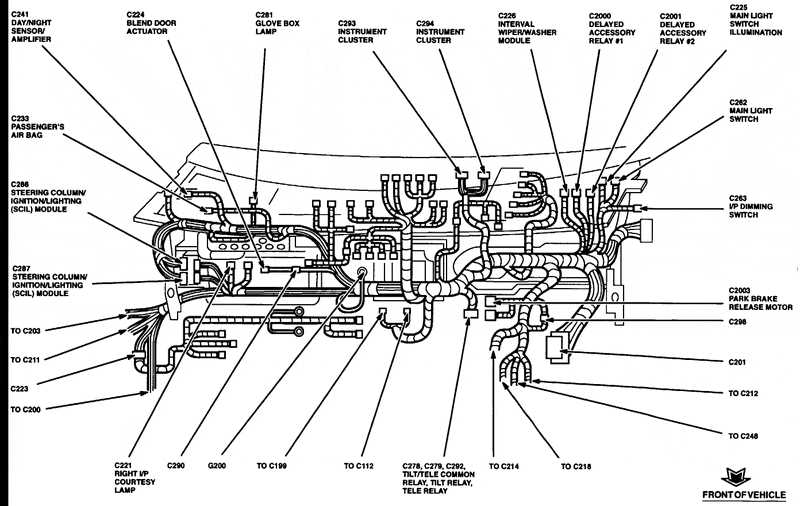

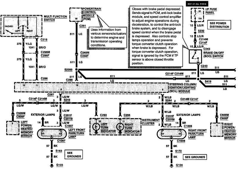

    Well, I searched but could not find anything being identified as a relay within the cd workshop manual, though I might've overlooked it. However, something tells me it might be alongside the steering wheel column by the ECU and/or ODBII connector.
    Nonetheless, I've attached the diagnosis & testing PDF.

    I've been through those threads however you make a great point I hear the clicking the loudest near the wheel thanks that really helps especially the diagrams.
