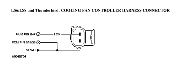

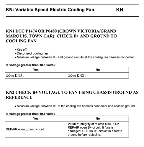

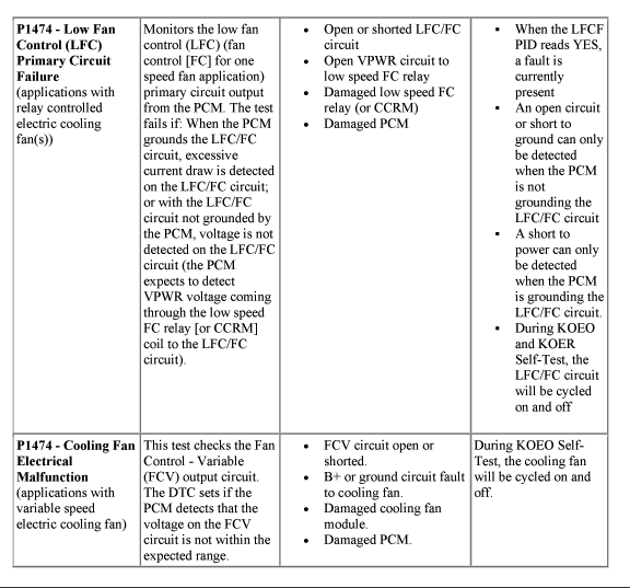

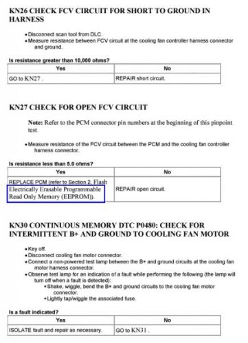

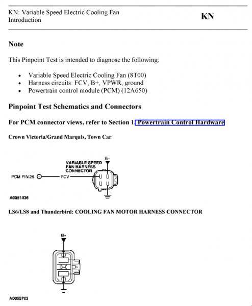

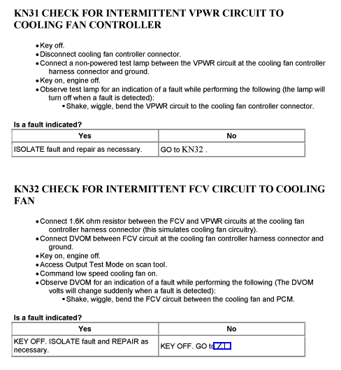

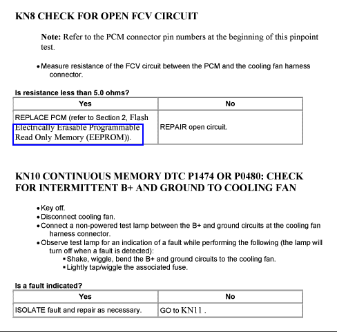

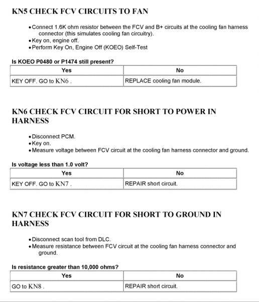

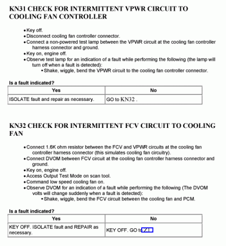

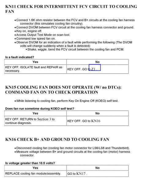

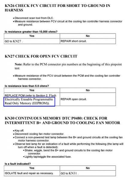

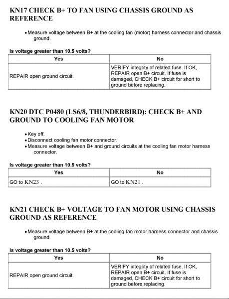

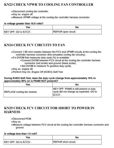

Here are some diagrams for a pinpoint test
Its a 2000 lincoln ls, it has the hydraulics fan so im not sure what circuit wouldit be detecting as open?[/QUOTE]

I have a subscription to alldatadiy.com
If you need any assistance with what a code means or steps to fix your car just let me know and i'll look it up for you. Hope this helps otherwise good luck.......

Alldata says check the wiring to the solenoid and the solenoid (resistance). If it's not the wiring or the solenoid it looks like the PCM needs replacement.
