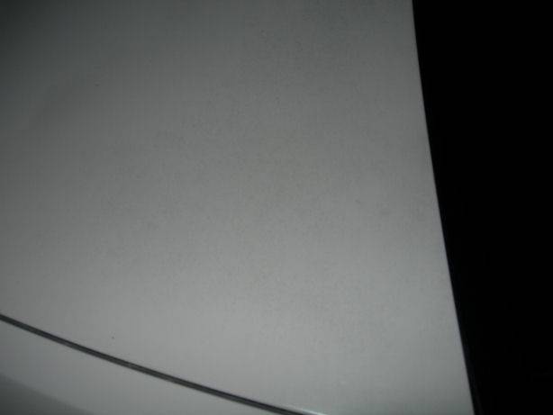

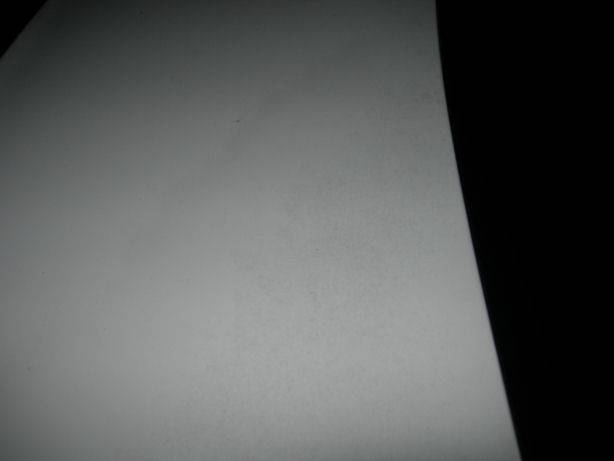

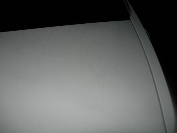

I got pics, I hope they show enough detail.
SurfjaxLS said:
I detail cars for a living and have encountered this problem several times (now that I see the pics and have your description). Many times, a car will get a contaminent on it such as bird droppings or another chemical. When this happens (depending on the properties of the contaminent), it will seep through the clearcoat and harm the clearcoat itself.
To give you an example of this sort of thing, a customer brought his car in the shop to get detailed and it had a lot of bird droppings on it (some older than others). Some of the newer stains that the droppings left were only able to come out with the use of a heat gun (buffing it did not do a thing). Some of the older stains had ruined the clearcoat and there was nothing that could be done.
If you want to try the heat gun technique, hold the heat gun about 2-4 inches away from the paint and go back and forth with the gun for a few moments (not for too long as you will bubble your paint).
I don't know if this could be the problem with your paint or not without getting a detailed look and feel at it. But, it is worth a shot. Other than that, try claybar or rubbing alcohol. Hope this helps.......but at least now you'll know how to get bird dropping stains out of your paint.
It's weird because my car never goes more than 2 weeks at most without being washed. And when the birds are out, I was it once a week. I parked under a tree all school year last year, so maybe some stuff came off of the tree and onto my car.
Would it keep spreading though, even if the crap is gone, or once the paint starts to blemish does it continue?
