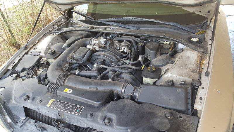

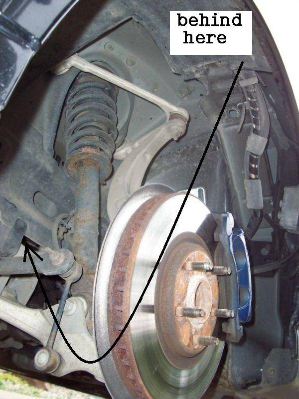

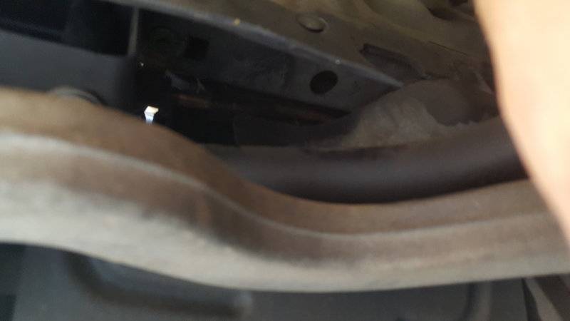

I tried to recharge my AC today (quite necessary if you're living in Phoenix like I am.) but cant seem to find lower ac pressure port. I've checked both under hood and behind front driver side wheel. I've attatched pictures of my engine layout and under wheel cover in hopes of anyone finding it.
Follow the lower control arm in central of that there is a black flap part of the inner wheel well plastics. You'll need to lift that up and look upwards in and you should see the port fill cap.
- drivers side
