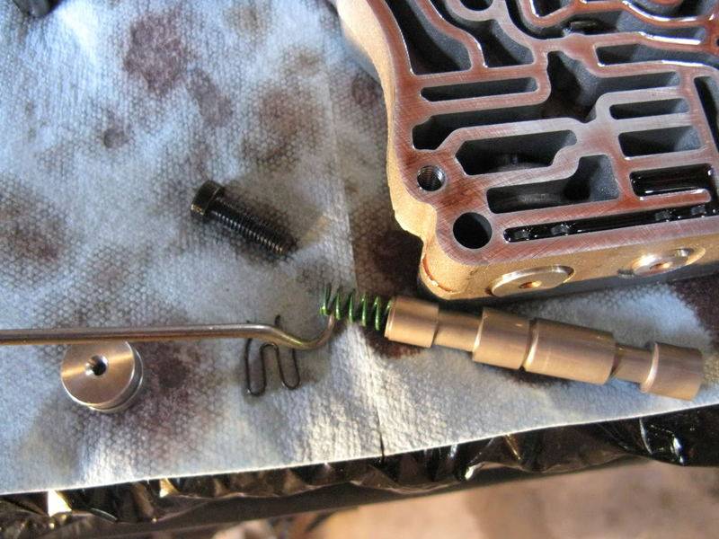

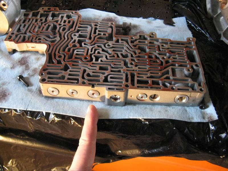

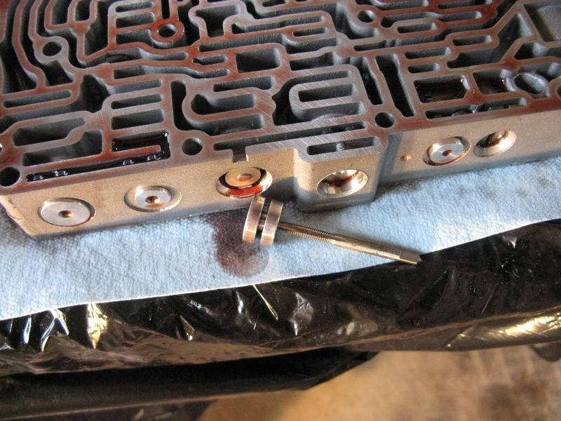

        Thanks, I wasn't planning on buying a whole new valve body, just the one $5 spring outlined in the "5r55 Repair" thread. I may just leave well enough alone.
        And, am I correct in understanding that the 10mm "bolt from h*ll" on the solenoid connector is outside of the pan? IOW, one could unscrew the bolt prior to taking off the pan, right?
        Here are the pictures of the 3-4 valve spring:

          Yes! And it's a pain to get to that one bolt. I would say it's the worst part of the entire process! I bought a rebuilt valve body and solenoid for like $140 shipped so I am not so sure about replacing the spring inside the valve body.
