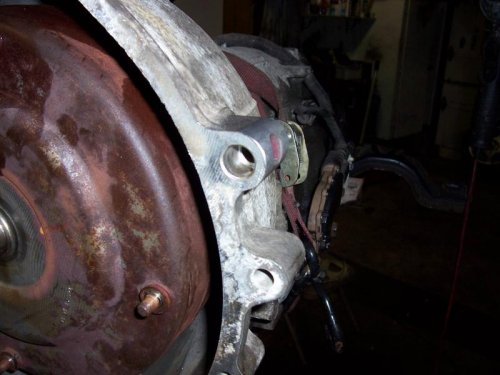

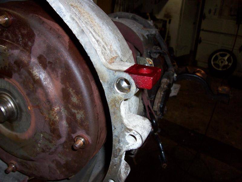

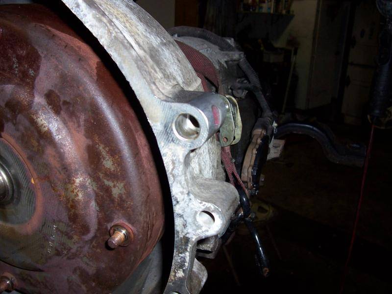

Once you and a buddy man handle the old one out make sure you grind off this ear on the new one to make installation much easier.
