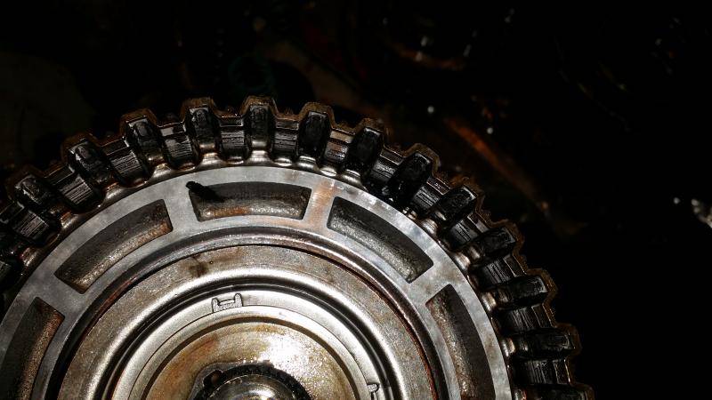

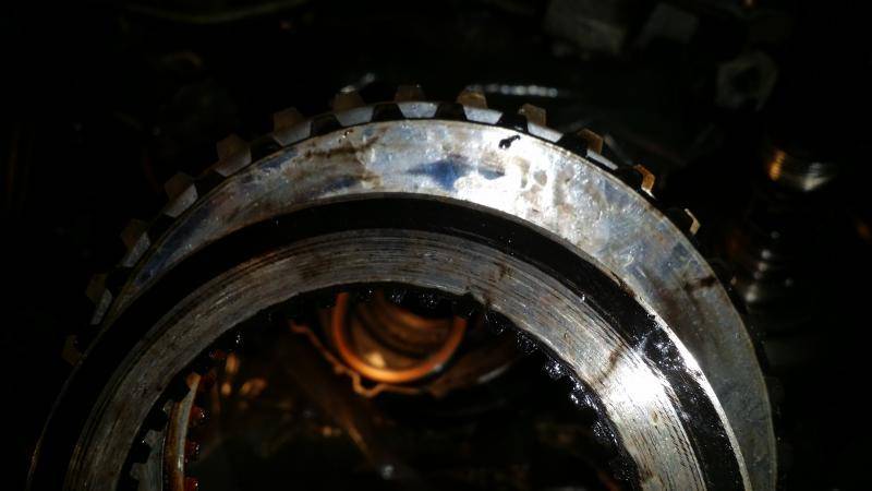

Finally decided to take the transmission apart. Found problem outer forward piston seal blown out. Lol look at that clutch no friction material left and warped lol really bad .
