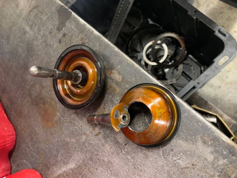

I got my car back yesterday afternoon and it runs GREAT!!!! It also seemed to ride a bit smoother and tighter. Not sure if that is a function of going from driving my dad's Ford Ranger or not. Here's a picture of my broken servo.
did they tell you the cause?
244k miles on a transmission that has a usual lifespan of 150k or less...the main cause of the servo isssue is that the servo Rod is steel and the case is Al. That causes the case hole to wear unevenly and eventually fail. Also, clutches and springs in valve body were worn. All the usual suspects in a 5R55 transmission.
