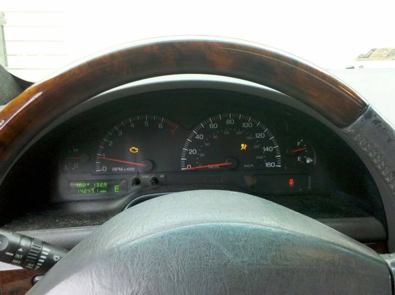

Recently i Saw a big E on my dashboard. it comes on every so often after driving at least 10-15 miles
i took it in and i have no codes related to the transmission .
can anyone point me in the right direction?
i fixed the Clockspring. so the airbag light is no longer there. the check engine light is no longer there. that check engine light was only there for a few minutes. THE E only came up a about two times also
...Recently i Saw a big E on my dashboard. it comes on every so often after driving at least 10-15 miles
The solenoid pack will fix the delayed engagement.
The "E" is a transmission error. It may be caused by the solenoid pack failure. Mine never got to the point of throwing the "E". I replaced it when the delayed engagement got unbearable. It could (I think) also be caused by a bad shifter. Next time it does it jiggle the shift lever (or switch from D5 to D4) and see what happens. My shifter died while under warranty so the dealer replaced it.
