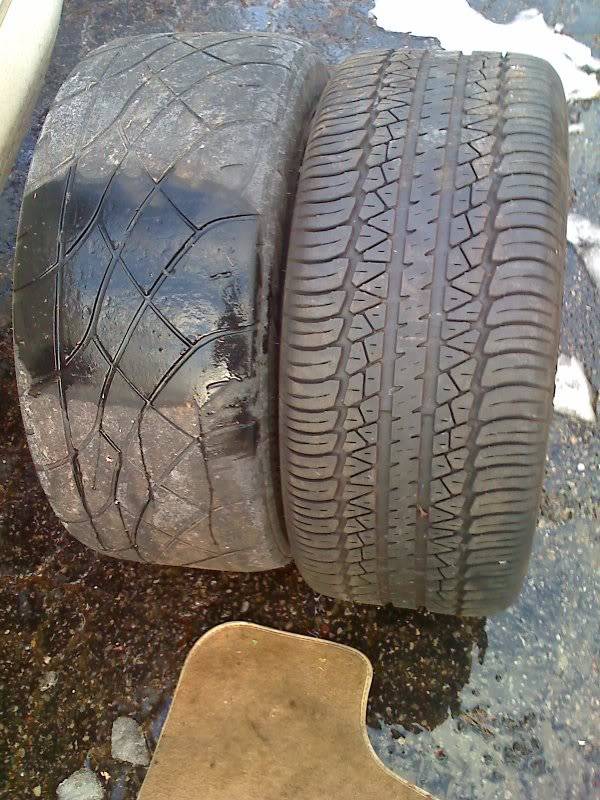

Yeah well if I actually fix the drive shaft then I will have to throw on this set of the winter street slicks for E-town :D
